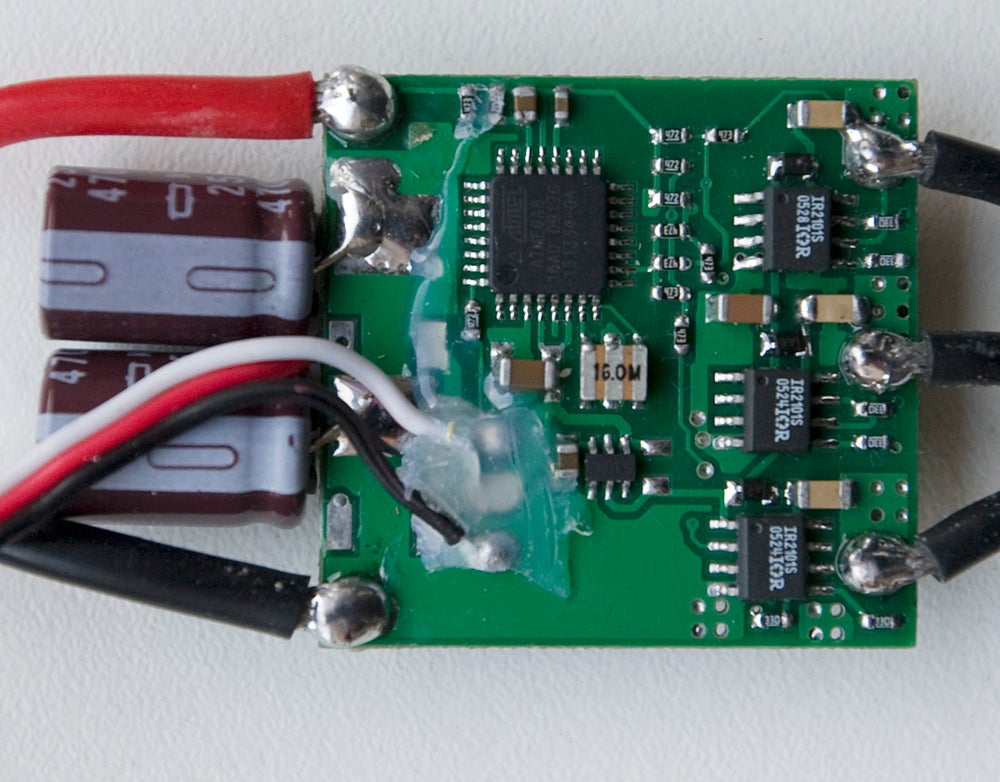

2x more ESC's successfully flashed and tested:
- i posted Mystery Cloud 50A photo earlier:
flashed with rb50a.hex (with SLOW_THROTTLE, BRAKE) - works OK. Looks the same as RedBrick 50A.
- Himodel 70A ESC: http://www.himodel.com/electric/HiMo...X-70A-BEC.html - it's the same as RedBrick 200A, just much cheaper. Used birdie70a.hex (again with SLOW_THROTTLE, BRAKE) - works OK, but didn't tested with more than 40A (no spare motor that could take such current). Only problem - MLF package, not so easy to solder pins...

Hello! Thanks! Added to the spreadsheet.
I think the HiModel GX series, the HK-SS, and the Red Brick and Birdie ESCs probably are all made at the same factory. The 50A, 70A, 200A, etc. models are usually _not_ consistent, though. You may find if you order one the next month it will be a different pin arrangement.
