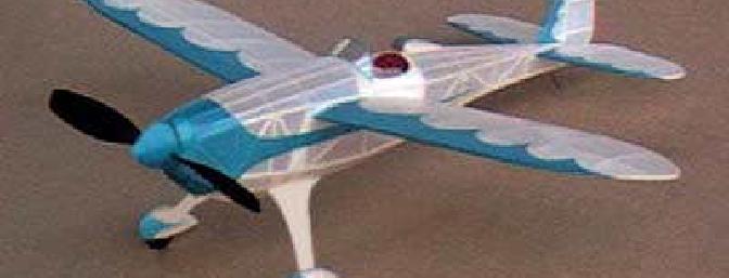

StevensAeromodel has a Daddy-O 525 waiting for you. It is a knockout gorgeous airplane, and when it comes to flying, it is spectacularly well behaved. Believe me you owe yourself one, but there is just one catch. Daddy-O is a kit and not the kind you can build while the battery charges. This is one you build little by little from that miracle material - balsa wood - in this case, beautiful hand selected balsa wood.

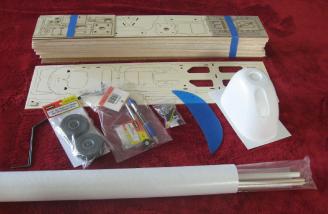

Nothing fills me with joy like finding a new airplane sitting on my doorstep. In this case, Daddy-O's carton was an impressive 8 x 6.6 x 6.5 inches.
The carton label tells you a lot and contains, and you are going to find its full color photo of the plane very useful.
I couldn't wait to open the carton. There was no inner box and the contents were loosely surrounded by crumples of brown paper; nevertheless, everything arrived in perfect condition and there was a surprise inside. Along with an impressive packet of sheet wood and a formed cowl, there was a 48 inch long white tube. "How nice," I thought, "they have rolled the plans and protected them in that tube." I popped it open and found only strip wood. Hunting through the carton, I still found no plans. "OMG, they forgot to pack the plans! What will I do?" I did what most of us do as a last resort. I looked in the manual. Right there,under Kit Contents, it says "No plan sheet is required or included with the kit." I wondered how things would work out with no plans to work over as I have always done, but I trust Bill Stevens, and was confident that everything would work out just fine. They did
It is not at all uncommon when building from a kit to discover that some of the supplied material is unsuitable, balsa that is too hard, or too heavy, or too soft and/or hardware that is shoddy. If you build a lot, you search your scrap box for replacements. Otherwise, it is off to the hobby shop to buy them. Not so with Daddy-O. With the exception of the required electronics and covering materials, everything you are going to need is in that box and the quality is 100% outstanding.

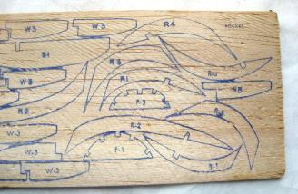

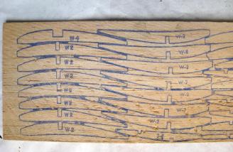

The heart of the kit is a bundle of 29 sheets of perfectly laser cut parts, mostly of balsa but some of plywood, each with a burned in part number and, when required, indication of which is the front side of the piece and its top. This level of thoughtful detail is found throughout the kit. Do you think I exaggerate? At first I wondered why a ball point pen is included in the hardware bag? I laughed when I discovered that the cockpit hatch is secured by a spring loaded sliding latch and that the pen provides the spring. That's what I mean by detail.
The level of detail in the kit is matched by the included 59 page manual. Each construction step is photo-illustrated and accompanied by detailed explanation. This is a kit that respects and takes good care of its purchaser.

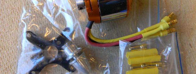

Motor
Daddy-O is designed for 300 watts of power. Several available motors will do the job well. Stevens Aeromodels recommends a Hacker A-30-16M motor or Stevens Aeromodels' own SA Sport Power BL 10e. I decided to give the SA Sport a try, especially because it cost half as much as the Hacker. It has been powerful, smooth and reliable. I think it is a bargain.

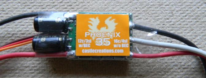

ESC
Stevens Aeromodels recommends the Castle Creations Phoenix 35 ESC. When I want a trouble free ESC that I can be sure of, I choose Castle Creations. Their products never disappoint.

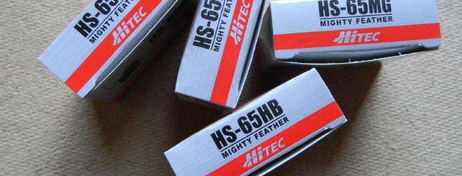

Stevens Aeromodels recommends 3 Hitec HS-65HB and 1 Hitec HS-65MG servos. Again, when I have a plane I am serious about, I choose these exact servos. In the past I have lost planes to the failure of inexpensive servos. I have never experienced a Hitec failure.

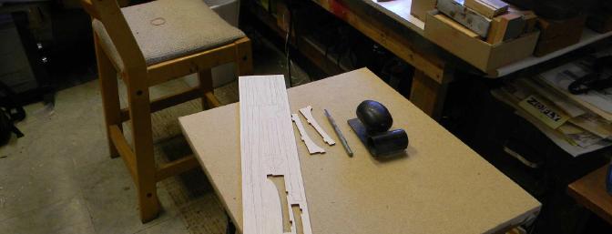

Sit down and read the Manual. Or, as Stevens says "READ and REREAD the instructions." Really, if you read the whole thing, you will have, right from the beginning, a better sense of where you are going and why certain assembly steps make sense.
Using a sanding block with fine sand paper, sand the back side of each sheet of wood. Stevens says they have found that most stock wood runs several thousandths of an inch over sized and this gets the sheets down to where they will interface accurately. I keep a small table alongside my workbench for just this purpose, sanding the sheets one by one when I first need them.

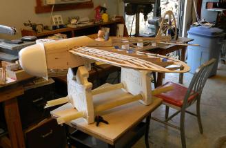

The fuselage is built around a core of interlocking plywood parts. They fit so well that you can put them together without glue and then glue them when you are sure they are right. Be careful that the parts are right side up with the front facing front as marked on the part.
Sides are attached to the fuselage core, then joined by formers and shaped with stringers. As you work along, notice the clever way that the landing gear struts are solidly secured within the fuselage.
A battery compartment hatch and a cockpit-hatch are built in similar fashion. Both are held in place with magnets, and the magnet holders are another of Stevens's unique and ingenious bits of engineering.

Because the parts interlock so well, you no problem building the wing without a plan. The ribs have tabs at the trailing edge and so long as your building board is really flat, the framed up wing will be warp free. The parts interlock in a way that holds the structure in alignment both vertically and horizontally.
Like the fuselage, the wing starts with assembly of a sturdy plywood core
The rest of the wing builds out from the core.
The ailerons are built separately with a carbon fiber trailing edge for strength and to prevent warping.

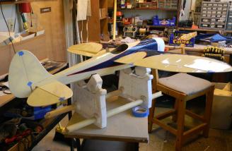

With the major structures built, fit them together preliminarily. Check the fit and alignment.
Covering
Have fun designing your own covering scheme. I covered the entire plane with antique white and applied the dark blue over the white. I simply placed the blue over the white, ironed the edges and shrunk the covering. I have read, however, that you can simply coat the base color with acetone, lay the trim cover over, and sponge down any wrinkles. I'm going to give that a try next time. I got the red striping tape at an auto supply store.
I can't imagine covering the cowl, but maybe it is possible. I suppose you could do yourself a favor and choose covering colors for which there are matching paints. As for me, good buddy and world class painter Glenn LeCartz mixed me up a batch of cowl paint. Thanks, Glenn!

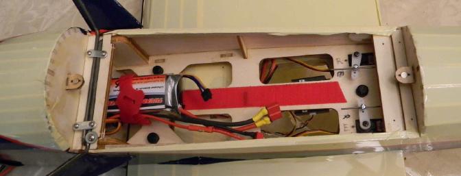

As described above, I installed the aileron servos during the covering of the wing and installed the linkages later.
The battery fits under the wing, held by Velcro and by a strap. The rudder and elevator servos are installed through the battery floor.
There is plenty of room on top of the wing for the receiver.

All I can say is what a sweet flying plane! Daddy-O does exactly what you ask of it, gracefully and with no backtalk. This is the kind of airplane you take to the field every time and never tire of flying. I'll admit my knees were shaking on Daddy-Os maiden flight. I was amazed that at low control settings and less than full throttle, the flying was nearly trainer-like and the first landing couldn't have been improved on. And when you are ready, open the throttle, switch to high rates, and discover that Daddy has an entirely different and very frisky personality.
Takeoff - absolutely no problem. Daddy-O steers well on the ground, requires little or no rudder input as it accelerates down the runway and lifts off straight ahead. I haven't had occasion to take off from grass, but I have seen videos in which other Daddy-Os do this with ease.
I have never had an airplane that is easier to land. That process that with other airplanes often has my knees shaking is gentle and predictable with Daddy-O. Keep a little bit of power on your final approach and the plane will practically land itself.
I can't say it any better than Mr. Stevens does:
"Daddy-O 525 is capable of most common full-house aerobatics including Snaps, Spins, Stalls, Wing-Overs, Stall Turns, Chandelles, Barrel Rolls, Lazy-8s, Cubans, and Loops. Will it 3D, mister? ... Goodness, I hope not! Besides, you'd look a might bit out of place hovering a Daddy-0 525 over the runway."
I just relax when flying this well behaved airplanes. When I reach out to try some new maneuver for the first time, I can trust it not to do anything scary
Stevens says this although this kit is recommended for intermediate model builders, he invites absolute beginners building it to contact his staff with questions and for help.
As for flying, Daddy-O is for those who have graduated from a high winged trainer and are used to flying with ailerons. It is gentle, but since it represents quite an investment in time and in cash, be sure you are ready and then take it up with every reason to anticipate a trouble free experience. Remember, when in doubt, there are experienced builder-flyers waiting to be asked to help.
Let's be frank. At $229, Daddy-O is going to give some of you sticker shock, but in terms of the quality and completeness of the kit, its excellence of design, its prospects for being long lasting, and the probability that you will enjoy it for a long time, it is money well spent.
Daddy-O has appealing looks, a strong, sound, light design, is a joy to build, and a superb flyer. There is no way you can go wrong with this one.
