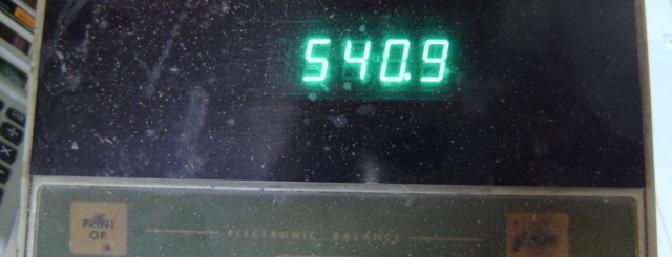

The plane had to be balanced from front to back on the Center of Gravity and from side to side do the length of the wing span of the plane. The left side of the wing was heavier then the right side of the wing. This required the addition of weight to the right wing tip to balance the plane laterally. A screw and a nail provided the necessary weight for the right wing tip and were secured in place to balance the wing.
To balance the plane on the C/G it was a question of trial and error by adding weight until the desired point of balance was achieved. The initial balance point was 25% back from the wings leading edge at the fuselage. The plane is designed to haul a camera and transmission gear up into the air and without that gear ballast was needed to supply the weight. Jeff added 540 grams of lead ballast to the front "cockpit" area for the fuselage to obtain his desired C/G balance point for the initial flights. We will remove some ballast and see how she flies with the C/G at a point 28% of the wing back from the leading edge.
