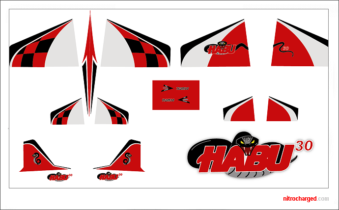

I've just about finished doing up my own set of plans and have already finished the artwork which will be paper slide decals as they worked so well on the 25mm Micro Hawk (they almost look painted on the depron). Even the Habu logo was begging for the 32 to be changed to a 30 to reflect the EDF size!

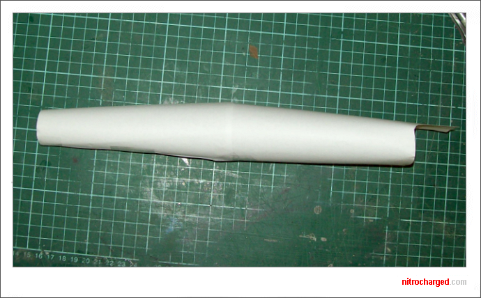

The main fuse will consist of 2 pieces of formed depron. I did a dummy fitting of the fuselage shapes today using paper cut-outs. I hope you like rolling depron because I will be avoiding box construction as much as I can on this one.
The forward piece has the upper intake flanges on it to simplify that area and allow the front to be a guide for the forward fuse/inner intake walls that will be inserted into place.

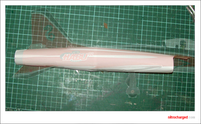

The rear is a taper from the ellipse to circular exit. It looks weird by itself and you'll probably scratch your head thinking "what the...?" so I superimposed the fuse of the Habu to show you where this is going so far.
