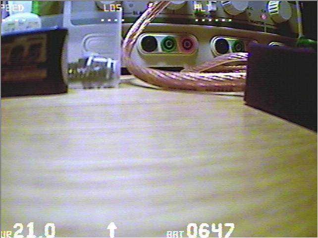

Is there easy way to move top line more up and bottom line more down, basicly on edges? My cam outputs wide screen, so i have black lines at top and bottom, so i want to use this lines as backgruond.
You just need to edit the line-number, should take a couple of seconds
On my screen the text is almost at the top. When using the video-grapper the pictures is quite different. You can change it yourself and make it match your googles/screen.

Better late than never....
Here goes...
The normal hardware version is more or less the same as earlier.
With my cheap china cam I had to use a diode with a little higher forward voltage drop, or increase R3 to get a stable sync.
More or less the same as here
http://www.viennawireless.org/balloo...rlay/index.php
  • R1 - Controls brightness of the text. Around 100 - 300 ohm recommended.
  • R2 - Control dimming. Feel free to try whatever resistor-value you like.
  • C1 - 0.1 uF is the standard value used to AC-couple video, but other values should work fine. I have even used sround 25 uF capacitor
  • R3 - a part of the climping circuit. Around 10K should do it.
  • R4 - The diode (in this case D5) will always have a voltage drop of 0.6-0.7 V. R4 is just used to limit the current flowing from VCC. Values from a few thousand ohms to 100K should work.
  • R5 pot is used as a simple voltage-divider. The value is not very critical, but I wouldn't recommend very large (1M) and very low (100 ohm).
In this version the fast PWM is used to generate the DC-voltage used for bias and reference voltage.
  • R4 and C2 is used as lowpass-filter.
Simple version - I wouldn't recommend it, but I think it's a cool way to do it
I have been able to get a good sync, but it's a bit easier and more precise with a pot.
- off cource you can change the circuit as you want. You can also use the pot as voltage-divider for the biasing voltage and leave reference voltage at ground etc. Do whatever you prefer.
If any hardware-guys can improve the circuit - go ahead

Here is the latest code-version.
Guess this will be the last version before further test-flights have been done
I might add number of satellites locked on GPS and INA139 example - but at the moment test-flights will be prioritized
Image is pretty blurry - but it does give an idea about the current version
Dennis Frie is offline Find More Posts by Dennis Frie

I also noticed the HK camera needs a lot more dimming than my FatShark camera. The 50 ohm resistor works fine on the HK camera, but on my fatshark camera i found that it dimmed more than necessary.

The hardware-design is not completely perfect. If you take a look at commercial products used to detect video-sync, the circuit is far more sophisticated. This is an easy and pretty good way to do it, but it might not be perfect.
The main problem is, that some cameras will need more than 600 mv bias to get the sync-pulse raised above ground. Preferably I would have used a 0.7-0.8 volt zener-diode, but I also wanted to make it as simple as possible - and with standard components. Using a single 4148 diode gives you around 0.6-0.7 volt. While this should be fine for normal cameras, it's not quite enough if you use for example the cheap HK camera. Replacing R3 with a 100K ohm resistor will do the trick, but i'm not a big fan of a pull-down resistor that high. The trick with the PWM signal was just another way to create the voltage that could have been obtained with a zener-diode.
So, the short version. If don't want to "test", I would either recommend Schematic 1 and use a 0.8 volt zener-diode instead of D5, or just use the schematic on page 1.
Be aware that the 50 ohm dimming resistor might be too small. Better give like 100 ohm a shot.

This is small text/numbers;
From one of the first versions. Unfortunately I found it very hard to read in my fatshark googles.

Well, NTSC version was easy enough.
Just change these two lines:
#define butlinenumbers 261
#define butlinetext 279
to something like this:
#define butlinenumbers 212
#define butlinetext 230
I also moved the top text up a bit to get it inside the black area of the gopro video out signal. Here is the numbers I use:
#define toplinetext 5
#define toplinenumbers 15
Cheers,
Andreas
andreas77 is offline Find More Posts by andreas77
Cheers,
Andreas
Nice
That was even easier than I expected
If you use the black background from the GoPro you can remove the dimming by changing;
#define DimOn DDRB |= 0b00000001;
#define DimOff DDRB &= 0b11111110;
to:
#define DimOn DDRB &= 0b11111110;
(removing it will mess the timing a bit, but you can also replace it with a nop)

Originally Posted by andreas77 View Post
I think that was the answer I was looking for, thanks!
So it works like this:
frame sync => ~314 odd lines => frame sync => ~314 even lines
not like this (like I thought)
frame sync => 625 lines (half odd / half even)
I also think the resolution is good enough as it is, I'm just trying to understand how it works.
Jep, the controller will see;
or 50 frames per second with something like 314 lines.
Great, but when I think about it some more, wouldn't that make every character twice as tall? For example, the small letters are 8 rows tall. If all 8 rows of the character are written to all frames, the character would end up being 16 rows tall in the complete picture, wouldn't it? Again, obviously everything looks and works great and the characters doesn't look stretched either. I should probably just accept the fact that it works, but it annoys me when I don't fully understand how..
Year, but only twice as tall compared to the use of 8 lines instead of 16
The width of the letters (or the width of 8 bit) is defined by the clock-rate and SPI-settings. The height is only defined by the lines. If you use single line (only even or odd) the height of 1 "pixel" will result in a "long" pixel. Using 2 lines as height and max SPI speed seem to give an pretty good pixel-form

Originally Posted by msev View Post
I have another idea - alarms (blinking text), but I guess one would have to be code literate to modify them to one's liking...
Can be done pretty easy, and the "limits" can just be defined at the top like this;
#define altitude_limit 150
I don't mind to implement it if anybody is gonna use it, but I don't really feel the need myself
EDIT; quick implementation done on altitude limit, works fine
By the way. Ideas for improvement are welcome, but support for extra sensors etc. will not be added now.
