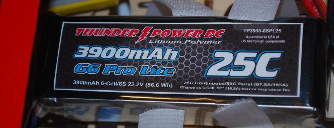

<font size=-2>Thunder Power G6 Pro Lite 6s 3900mAh LiPo battery</font>
Capacity:3900mAh
Voltage:22.2v
Number of cells:6
Weight:534g
C Rating:25C
Max. Continuous Current:97.5A
MSRP:$159.99
The Castle Creations ICE 75 AMP ESC and Thunder Power 6s pack were perfect for providing power for the Telemaster Plus. I have used these products many times in the past with flawless results. Both performed without a single issue in this large model. I used a 1200 watt 435g motor I had on the bench for power.

Now it was time to focus on the battery area. The Telemaster Plus has a large, magnet secured battery hatch in the top of the fuselage. It is sure great to have a top hatch for battery changes as it speeds battery access appreciably.

The Thunder Power Pro-Lite G6 pack has been performing flawlessly in the Telemaster even on these hot 100+ degree days we have had this summer. The generic 60 size motor produced the following results:

Battery
I used the capable Thunder Power G6 Pro-Lite battery for the Telemaster. These packs are high quality, have an excellent warranty and they perform exactly as advertised. They are true 25C packs and in today's battery market that is not a claim many can make. I fully trust the Thunder Power line and have been a long time customer of their quality products. What is more they are very light! Performance of the G6 Thunder Power pack was simply stunning as can be seen by the high voltage under load.
