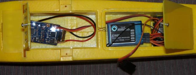

The wing with its individual aileron servos is attached next and installation is almost as easy as it gets. I say "almost" because the leads for the preinstalled Y-harness need to be fed up behind the rear bulkhead and the servos plugged into each plug. It took some noodling to fit the front mounting tab and to keep it from popping loose when the Y-harness was gently pulled back to keep it from getting pinched at the mount. I hasten to mention the manual fails to alert the owner to the need to feed the leads up the hole or the need to plug in the servos. It's obvious, but it's also omitted.
The access hatch for the receiver and therefore the Y-harness is held down with a preinstalled screw, but the screw fit loosely in the hole with evidence of plastic shavings on the threads. A slightly larger and longer screw from my parts bin fixed that problem, but I would like to point out the same sort of setup is used to attach the door over the battery/ESC compartment. Thankfully, that screw held fast, but having to install and remove that screw every time the battery is changed will not only be tedious, but will result in either excessive wear of the hole or failure of the very small and weak hole in the hatch. The latter actually happened while I removed the screw on the bench a few days after the maiden flight; the little plastic tab simply fell off the hatch!
I found a mini servo arm in my parts bin and screwed it down in the opposite hole holding the receiver hatch. To ensure that the arm wouldn't move in flight, I drilled out the hole in the arm immediately above the original screw hole in the fuselage and I used the original hold-down screw as added insurance. It threads through the servo arm and engages the hole; that arm isn't going anywhere in flight. The battery hatch itself is hinged, so there won't be any stressed plastic to break like a credit card. I may look at the possibility down the line of using some rare earth magnets to secure the hatch, but the servo arm works well.
Two 6x10mm machine screws attach the wing to the fuselage, but the enclosed screwdriver is too small for the job of attaching them. A regular P1 phillips will do the trick.
Pushing down too hard might cause one of the 6mm nuts pressed into the fuselage to pop off. I found this out later when I had to remove the wing, but all went well after I popped the nut back into place and used a bit more care to thread the machine screws. Between the servo extensions and the now-glued wing braces, putting the wing back on was a real challenge, primarily in trying to keep the ends of the struts from scratching the finish (they didn't) and in tucking the servo extensions back behind the bulkhead. Unless I have a real need to remove the wing, it's staying put.

That said, the exterior belied how sophisticated the innards really were when the model was fired up and the final clevis adjustments made. All the servos responded smoothly with no chatter and although the sticks felt loose, it was more a matter of perception and personal taste. There was no unwanted servo movement because of the sticks. It won't be the prettiest radio on the flight line, but it will work as well as any of them. It's light years ahead of the old 27MHz radios that would have come with a model in this price range once upon a time.
A quick check of the motor operation showed that it revved like crazy with a tremendous amount of torque. Like the servos, the HobbyKing-labeled motor with its thin body and long shaft is not found on their website other than with this model. There was some vibration at full throttle, so a prop balancing session (or replacement) will be in this model's future. The pilot doing the running commentary on HobbyKing's YouTube video claimed that the model was cruising at around 1/4 throttle and it was still honking along well.
Electrically speaking, it's a well-matched combo. After cobbling together some adapter leads made fom old JST and Deans connectors, my Astro Flight "Super Whatt Meter" showed a current draw of 13.95 amps (well within the comfort zone of the battery and ESC) and 10.23 watts of power at 12.4 volts prior to start up. My Hobbico tach showed a prop speed of 9050 RPM. These numbers may not be entirely accurate given the thin leads of the JST adapters, but they're certainly close enough to give a good idea as to how the combo works.

You know, someone brought this into the shop the other day, and the motor was running backwards. We just switched the wires, but this could be a bit of a manufactoring error, or pilot error. Instructions aren't very clear on which way the prop goes either. Well, that was just a little imput I had.

Thanks for that input. With a brushless motor such as the one in the Cub, reversing any two wires will reverse the direction of the motor. Viewed from the front, the motor should spin counter-clockwise.
As for the prop, any plane with a front-mounted engine or motor requires the prop be installed with its manufacturer mark and size numbers facing toward the front. That's the sort of thing that's obvious to an experienced user, but not to a beginner if it isn't mentioned in the manual. In the case of the J-3, it's clear which way the prop faces thanks to the hexagonal opening at the rear of the hub which engages with the nuts on the motor shaft.
A pusher prop jet's motor rotates clockwise when viewed from the rear with the numbers on the prop facing away from the rear. In other words, the prop is rotating in the same direction as a front-mounted setup when viewed from the front.
