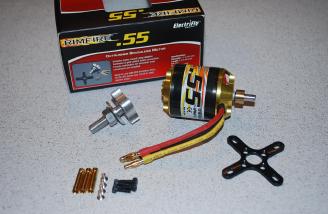

<font size=-2>Rimfire 55 brushless motor</font>
Type:Brushless outrunner
Weight:268g (9.5oz)
Output shaft size:5mm
Cells:5-6S Li-Po
RPM/Volt (kv):480
Continuous Current:45A
Burst Current:80A
MSRP:$79.99

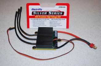

<font size=-2>Great Planes Silver 60A OPTO HV ESC</font>
Continuous maximum current:60 amps
Input Voltage:4S-12S LiPo
Input connector type:Deans Ultra
Output Input connector type:4mm female gold bullet connectors
Weight:89g (3.13oz)
OPTO Isolated:No BEC
MSRP:$99.99

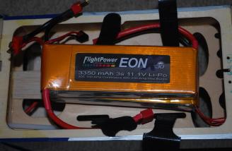

<font size=-2>2 - FlightPower 3s 3350mAh 11.V LiPo battery</font>
Capacity:3350mAh
Voltage:11.1V each for 22.2v
Number of cells:3 each /font>
Weight:279g (9.8oz) each
C Rating:30C
Max. Continuous Current:100.5A
MSRP:$84.99

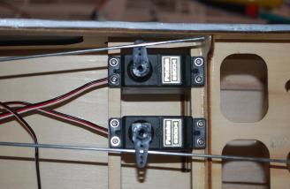

Installation of the servos was a snap as the recommended Futaba S3004 BB servos fit with no modifications. The factory had routed a string to allow the builder to quickly pull the servo leads to the wing center. You will have just enough end plug to attach the your "Y" cable or short 6" extensions.

The motor installation was easy with the included laser cut plywood box. The tabbed box slid onto the firewall and a bit of CA glue had it secured. The box has blind nuts pre-installed for the Rimfire "X" mount.

Since the ESC is OPTO isolated you must use a BEC or battery to provide power for the airborne system. I choose the Hobbico Life Source 1100 battery. It was able to provide 6.6v to the airborne system providing excellent power for the radio system and servos.

Two 3s 3350 MAh FlightPower were used to provide power for the Mustang. Each of these packs weighs in right at 9.8oz/279g. An adapter was used to combining them for 6s power. Performance of these packs was stellar as can be seen it provided great voltage with the 44amp load.

In order to attain the proper CG the two 3s 3350MAh packs needed placement right in the center of the battery tray. It is always a great joy when no extra weight is needed to balance models.
