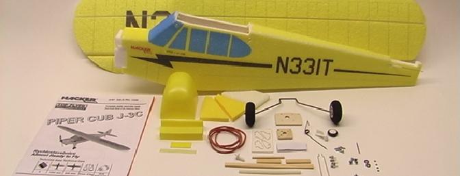

Each Cub version brings something to the airfield that reminds us of the history of aviation and that creates an enthusiasm for RC flying. I have flown Cubs from small foamies through giant scale, and each has a personality of its own. There is ne thing I would say about the ones I have liked: They tended to fly like a Cub; slow, deliberate, wide turns, stable in a stall and easy to land. Hacker’s EPP J-3 Piper Cub is one that meets my criteria of a great rendition of the venerable Cub, from the components, to matching the right engine, through the build and at the airfield; this Cub is an excellent addition to really anyone’s hanger.
As an EPP model, the kit comes with well cut parts and components designed to specifically meet the needs of this Cub. The model is pre-painted with a light almost transparent coating with painted on decals, windows, panel detail and N-Numbers. The yellow is bright, but not as bright as some kits. The size is obvious, and this Cub has lots of qualities worth investing in and flying.

The manual is well illustrated and is translated in at least five languages. Billed as a “Top Flyer Almost Unbreakable” aircraft, the Hacker Cub assembly is easy to follow, and I found nothing left out that would lead to an incorrect build. The process starts with the wing and ends with the battery hatch. If I adapted anything in the assembly it was to get the mains on as soon as possible to get the fuselage standing upright. Let’s do a little walk around of the Hacker Cub.
The wing is a two-piece design and requires the installation of a wooden main spar. Because this is EPP you can use regular CA glue. Be careful to not over accelerate the drying as heat will damage the foam.
After you install the spar, the wing halves must be joined with a slight dihedral. I cut a piece of ruler to use to get the correct spacing between the wing tip and the table top. The center rib fit well with this slight angle. A main wing joiner is provided that is plastic and glues the two halves together. The J-3 does not use wing struts.
The servos are installed at this time and require you to cut into the wing to make the servo fit. While it seems like extra work, this method ensures the cut fits your servo. I used hot glue to hold the servos.
The fuselage is basically built and ready to go. You need to add the tail, firewall, wing attachment pins and landing gears. I started with the motor mount.
