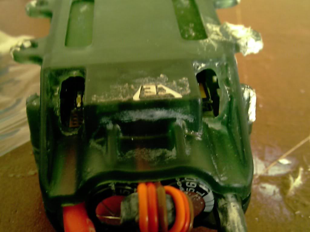

Pic 1 - Decided to keep some plastic around the caps to protect them, and prevent them from bending
the opening should provide airflow
Pic 2 - Front bottom - opted for side holes instead.
Note - Might cut open the entire middle section, next time I pull it out for service
Pic 3 - Back
please provide feedback, wonder what castle would say when I have to send this in for repair
Note - The ICE is not sitting flush in the FJ fuse, so air will go over, thru, and under Just need to try to keep the rat nest of wires neat

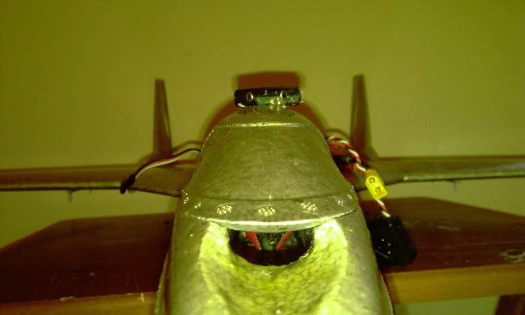

From last night - I added some Dave Brown CF tape to strengthen the motor mount area, If anyone plan on doing this, a word of caution - make sure the tape does not overlap, it will not allow the mount to fit flush, and cause a whole lot of unnecessary headaches, I wasted 1 hour cutting off the mount last night, pulling off and reapplying the CF tape, luckily I had an extra mount
Look closely and you can see the overlap

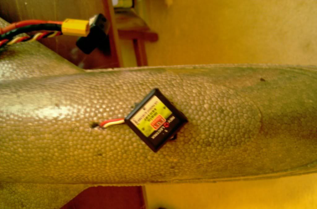

Co-Plot II - install currently underway
Main sensor installed, secured with hot glue
Front view - Looks a little crooked

Hey Flame,you should try to remove the top of the esc,I mean the little box plastic peice.With it elevated and good flow you will have some great cooling!!
Glad it was just a backwards plug for you and nothing to deep in.
for a temp gun there are a few different brands to be had.The pistol grip style is easy to handle,like anthing you will pay for good quality.
Greg.

Thanks for the tip, I was thinking about removing that front plastic piece, but was not sure, let's see what happens next time I need to salvage parts
Co-pilot save me

I like the cooling mods, I just keep in mind that MAX air is necessary, no matter what.
