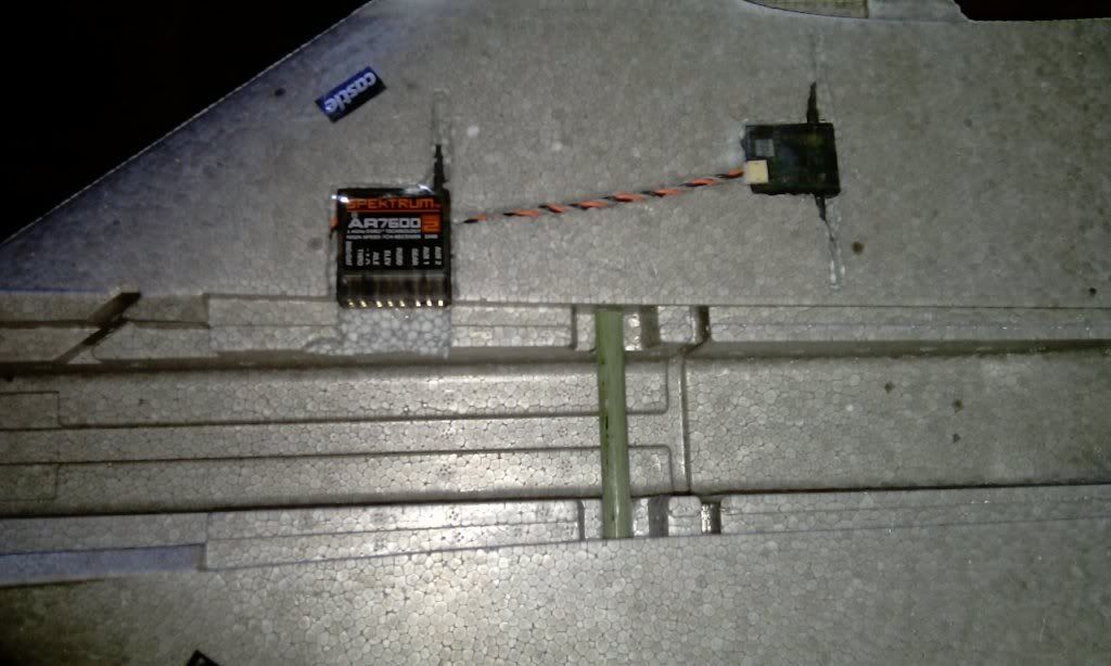

Ok decided to start a blog on my FJ Ultra build - these pics are of the one I am currently building, trying to make it as strong as possible to take abuse from newbie pilot
Most of the mod's are from other people, and a few I'm trying out like the enlarged cooling holes by the nose and motor, gets real hot here in the summer, don't want to fry my electronics or motor.
Used .310" arrow shaft to add some strength to the fuse and wing. Thanks RimRipper
Enlarged the cooling hole in front, to allow more air to flow thru the fuse, should keep things nice & cool, hoping it has no negative effect on flight performance
Added 2 10" CF rods on the side of the battery bay, should help to strengthen this area, also in the middle I used a smaller piece of arrow shaft to secure the battery straps.
I installed the RX into the right wing, this allows for the center to have less clutter, so air can better flow thru the fuse - Thanks Mopar
Installed robart hinges on the elevons, nice and strong, next time I will also fiberglass the elevons - Thanks again Mopar
Sanded some foam from the inside of the fuse to allow my motor and heat sink to fit properly, I then applied 2 layers of medium fiberglass cloth to strenghten the area, and will also add some CF tape around the lip, prior to installing the motor mount
Also note that I cut some foam from the turtle deck, hoping it will aid in keeping the motor cool - fingers crossed on this one
Added a BBQ skewer to each fin, hoping to gain some strength, and make the fin rigid, also filled in the hole on the side with lite filler, and will paint it with Z-poxy

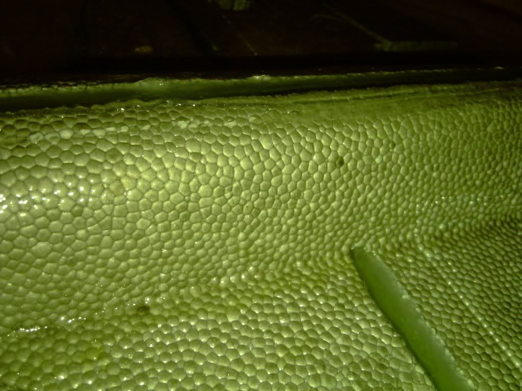

Trying to build this FJ as strong as Possible, painted the fuse with Z-Poxy and broke out the heat gun, looks like the resin absorbed properly, but need to wait 48hrs before I can handle the fuse...Thanks Mopar - will let you know how it turned out

I managed to repair FJ # 1 after plowing it, not once but twice into the ground Even with the arrow shaft I managed to break the nose off
Love those 4G negative dives - PULL UP, PULL UP!!!!
So it will live for a few more flights, this is a 3S setup with an E-Flight Six Series 2700Kv motor, ICE 100, and 6.3x4 APC

Hey nice builds Flame!!!Those big air ducts should really help keep things cool inside!!
Are you going to seal the gap up on the hinged fuse?
Your getting some GREAT building skills!!I cant wait for the video also,good luck on the maiden with the 6 series,Im sure it will produce some good speed.

Thanks RimRipper - I already closed the hinge line with packing tape, thats an old pic.
Forgot to mention I used 3/4oz fiberglass cloth over the nose area, to protect the enlarged air intake.
I am hoping it keep things nice and cool, I post feedback once I know for sure it's a worthwhile mod.

I like the green hard lizzard skin,did the the foam absorb the z poxy and kernal up?

Looks like it definately took, after the 48 hours, can you lay another thin coat of z-poxy over it to really stiffen and slicken her up ??
Looks like the kernals are very outlined, maybe a little too much. I found that getting just the outline of the kernals keeps things slick enough not to add excess drag. The second coat of z-poxy will help make it more slippery in the air.
After curing, I am VERY eager to hear how stiff you think she has become, especially with the additional coating of epoxy. Did you do the elevons as well ??

Sure I will keep you informed on how it turns out, So far I did the bottom section of the fuse, canopy, turtle deck, & verticals. Lotís of magical white smoke
As for the elevons I did not apply heat, I just painted it with a coat of Z-Poxy.
Once I complete the top section and itís fully cured, I will go back and apply a thin layer of Z-Poxy to both sides, or is it best to complete 1 section at a time

DANG
Those elevons would have LOVED to get some heat after epoxy. The second coat can be all at once, just hang her to cure

So I don't have to wait 48hrs before adding the 2nd coat
I will do the top part maybe tomorrow, and also heat the elevons.
Since I already painted one side of the elevons, and its dry, if I reapply z-poxy and apply heat will it still pop?
