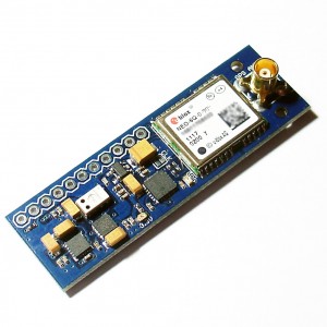

Can anybody send me a complete configured multiwii-sketch for an "11DOF IMU Board 5V HMC5883L BMA180 MS5611 ITG3200 NEO-6Q GPS" ?
My ACC->Z and MAG->YAW doesnt work correctly.
I've tested with and without soldered clock-jumper...
Can anybody help me ?

Solder clock jumper to GND!
solder also address jumper!

My board doesnt have an address-jumper. look at the picture...
My configuration:
#if defined(ALLINONE)
#define ITG3200
#define BMA180
#define MS561101BA
#define HMC5883
#define ACC_ORIENTATION(X, Y, Z) {accADC[ROLL] = -X; accADC[PITCH] = -Y; accADC[YAW] = Z;}
#define GYRO_ORIENTATION(X, Y, Z) {gyroADC[ROLL] = Y; gyroADC[PITCH] = -X; gyroADC[YAW] = -Z;}
#define MAG_ORIENTATION(X, Y, Z) {magADC[ROLL] = X; magADC[PITCH] = Y; magADC[YAW] = -Z;}
#define ITG3200_ADDRESS 0XD0
#define BMA180_ADDRESS 0x82
#define MS561101BA_ADDRESS 0xEC
#endif
