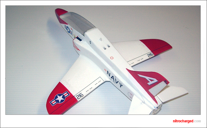

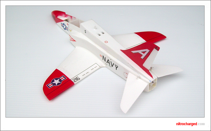

Team30 Micro EDF T-45 BAE Hawk - Ver4

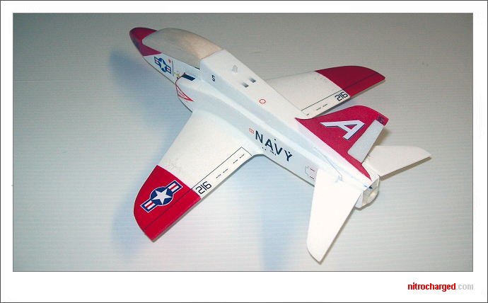

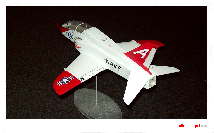

I am so happy to have finally got back to working on my Micro Hawk projects. It's been a year already since I last posted anything on V3 and here we are on V4 after stripping down V3 for desperately needed parts.
I have just completed it and have yet to maiden. I sleeked this latest one out slightly as an experiment in drag changes. I lowered the turtle deck height which followed forward with a lower canopy. There's another change too - it's a 25mm EDF, 12" version!

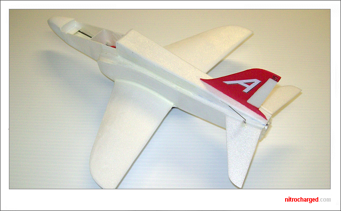

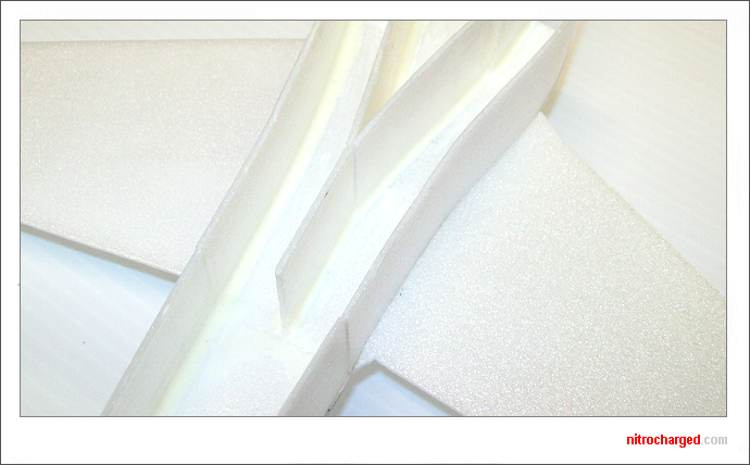

Construction started with building the base and side walls of the model up. I decided to make a mix of epoxy and micro balloons and line the joins with a triangular seam of it to act as strengtheners and also hold the depron together as the outer joins become wafer thin when the edges are sanded round.

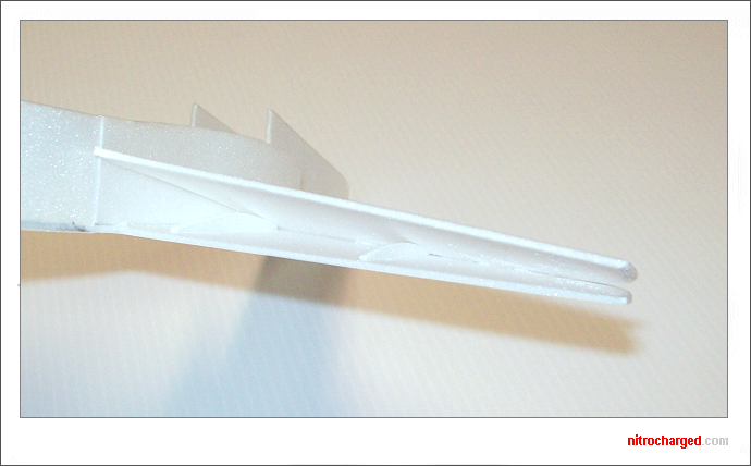

The wing is built up. Depron ribs hold the airfoil shape. There is no spar as the wing will get it's rigidity from the box of the wing.

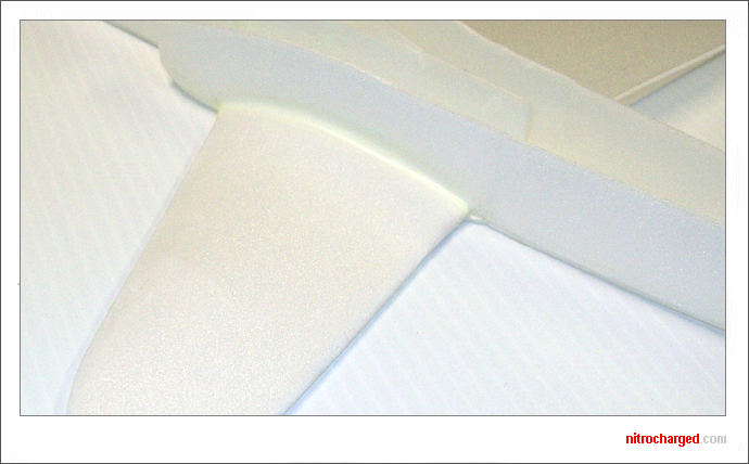

I applied another mix of epoxy/balloons to the wing join for strength

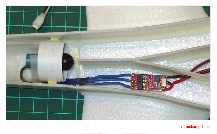

I installed the BIMRC 25mm edf unit which I fitted with a 10mm 1015 turnigy inrunner and clipped down GWS 30mm rotor with 3 blades removed. I balanced it out extremely well and it runs very smooth.

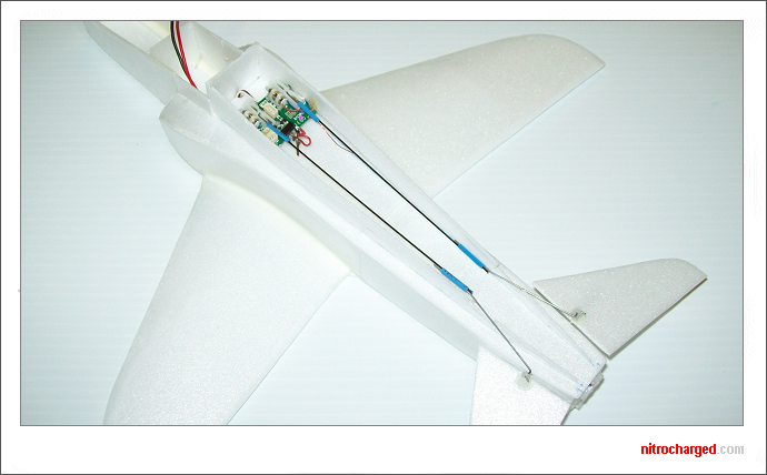

I mounted an AR6400 board on the base of the turtle deck and mixed into my DX7 so that the elevator and rudder act as tailerons and attached it to the full surface tailerons. I used a 1117 regulator to set the board voltage to 3.3V as I am using the ESC's 5V BEC. Handy if I want to go to 3S.
I closed the turtle deck up and dropped the vertical fin on. It's much easier to paint it first so you don't have to worry about fiddly masking. I also shaped and glued on the nose.
I then painted the model and applied the decal set I made for it using clear decal paper.

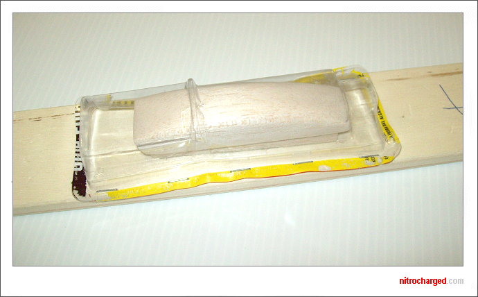

I shaped the canopy plug from a balsa block cut slightly oversize and sanded down to fit.
I used a 2 part epoxy syringe packing plastic stapled to a piece of wood to make the canopy. I hit it with a heatgun and let it shrink over the plug. I had to push a bit here and there to get it to conform to the plug.
I made the cockpit base and glued the trimmed canopy to it.
I added the canopy trim using adhesive vinyl cut in strips and trimmed as needed.
Ready for it's maiden!

dave...if you havnt already, you need some kind of inlet lip on that fan....sealed to the walls would be even better...

CN: It's taken care of but I didn't photo it.
