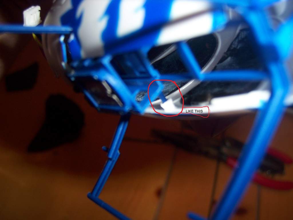

Q 6: I bought those OEM 120 mAh batteries from Hobby King but they won't fit or the heli won't turn on when the battery is in place. I did remove the "key" notch. Cheap crappy batteries?
A: These batteries are quite capable, but have 2 things to observe before use. First, some contamination can be present om the metal contact strips of the battery's connector. So it is advised to clean these before inserting the battery. Take a cotton swab and some cleaning alcohol, and rub the contacts a few time. You'll see them become shiny, where before they were a little dull looking.
Second, the corners on the connector of the OEM batteries are a little too sharp, and need to be rounded off some to make them fit as smoothly like a stock battery. A small precision file, like one that is used for fingernails, will do fine. The picture below shows what corners need some trimming. Use a small file or hobby knife to round of the indicated sharp edges. Test fit regularly to see if fit has improved enough. Picture only indicates this for one side, but repeat procedure at the other side for best results. It may take a few minutes, but these batteries perform well enough to warrant the extra effort in making them fit perfectly.

Q 7: I just unpacked my Bravo III and one of the servos isn't working. What is wrong?
A: Generally the best thing in such a situation is to contact the seller right away, but there are situations where this may not be an option, like when you bought the heli from a seller that requires the buyer to pay for return shipping for instance. And there is a chance you can fix this problem yourself, as it might be an assembly defect. On the next picture you will see that on the skids there are 2 pins that keep the canopy away from the receiver board.
Those pins should fall into 2 little holes on the inside of the canopy, but sometimes they aren't. This can cause the canopy to interfere with a servo, causing it to get locked. The next picture shows how the pin falls into the holes like they should.
When the pins are not in the slots, loosening the screws holding the canopy might give enough clearance to get them in the right spot again. For a third picture and some extra info, check this posting: http://www.rcgroups.com/forums/showp...9&postcount=12

The Bravo III I just received from MRC had one of the skid pins not seated in the fuselage. In my case, the up elevator did not work. Unfortunately, the skid was warped and would not allow it to seat properly. The aileron trim button didn't work either so MRC is going to replace the kit.....
I did loosen the fuselage screws and pulled the body away from the skid and the elevator worked again. So it seems that this may become a common issue.

Originally Posted by kablegod View Post
heres those photos....
Added now, thanks for the information. Also added some flight vids, a little info about the differences between the various versions, and a question about the tail rotor.
