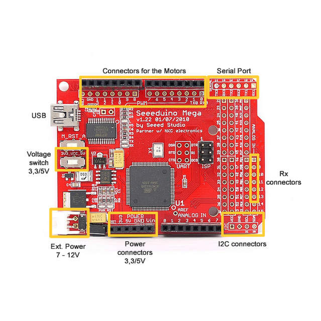

Thx for starting this, Jussi!
I was thinking of something easier and faster to develop, though.
My idea was a simple shield with pins that can be plugged onto the Seeeduino and has pins for
- your upcoming sensor board (I2C)
- pins for the motors/servos (maybe only 1 connected to 5V, all others only signal and GND wires?)
- pins for 5V going to the Rx
- pins for 3,3V for the sensors
- holes (serial port) for a GPS like this (25$):
I think this one could be designed and developed much faster...

@ Itod. I completely agree on using Aeroquad shield as a base-reference. And since most other duinobased copters are more or less derived from that, it is the obvious place to start. (I was kinda hoping to see Ted Carancho jumping in here and offering up his opinion)
@ Norbert....Impatient, as usual- huh Dont worry about the timefactor -I will put the long leg forward and get going with this. The major part of the work is to make the footprints and librarys for the Seeeduino Mega anyway. Once that is done, adding in extra features and connectors is very straight-forward!
I am probably not gonna add a PPM Multiplexer to begin with! There soon will several alternatives to DIYD/Paparazzi anyway!
But I do want a decent GPS connector and a connector for a Spektrum sat - those are must-haves in my world!
Besides that, adding in ekstra pinheader pads for other types of serial equipment is no problem!

Oh some hours off and you u did exactly what i wanted to do now.
I came here to the Forum and wanted to ask how we can make our own Seeduino Mega Board, and you did it allready, graet.
I still have the eagle files for the ardupilot, and sseduino 1.21 on the HD, i will have a look at the aeroquad shield.
I think it should be possible to add the FreeImu directly on the Mega Board with rubbermounts for Computer Fans.
We may should not use a pinheader for Freeflight Board, if we take flexible wires we may have a better decoupling with the rubber mounts.
Also there should be a posiibility to add all the ESC directly on the Board.
What Pins do we need for what?
Maybe you can clear this a bit up Kinderkram, i will be glad to "eagle" our "Flyduino" Board with our needs.
How much of the analog inputs do we need, with at least 12 we should be on the save side i think?
Which PWM outputs can we take for the Motors?
Which Outputs should we reserve for Servos, what limitations do we have on the outputs?
For Servo support we should have the posibilty to feed the servos over a external power source like a uBEC, but we have to decide which pins shoud be used for servos only, can you do that Norbert?
We can also take the ATMEGA2560 it isnt more expensive if we create our own board, but the only source we have is the big size original layout, but why not, we will get it a bit smaller.

Now that we have more designers involved I could ask the coders to have a look at the board.
@ Goofy: from what I know (and I don't know much) the analog ins 8-15 can be used for the Rx and the PWM 1-13 can be used for the motors/servos.
In the code that Mariano developed for the pins are used like that:
Code:
RX
Analog  8 - AUX2 (Not used)
Analog  9 - AUX1 (STABLE - ACRO)
Analog 10 - YAW
Analog 11 - PITCH
Analog 12 - THROTLE
Analog 13 - ROLL
MOTOR PIN (QUAD MODE)
 3 -  FRONT
 9 -  REAR
10 -  RIGHT
11 -  LEFT
Not tested for Y6 and Hexa configurations
 6 -
 5 -
SERVO PIN (not tested yet)
 7 - PITCH servo
 8 - ROLL servo
LED PINS
13 - LED PIN
12 - POWER LED
 4 - STABLE LED (added by me, ON when Stable mode is activated)
Other PINS
(if V battery monitoring)
A0 - Baterry PIN
31 - Buzzer PIN
I2C PINS
20 - SDA
21 - SCL
Signed,
Notorious Norbert
