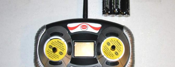

The Transmitter
This is an identical transmitter to the one that came with the Proto Max helicopter I reviewed last year. The transmitter surprised me with all it could do. The transmitter was identified as broadcasting on 2.4GHz. Beyond that, no specific information on the method of broadcasting was supplied. I flew my Proto Max helicopter with several other aircraft on other companies’ 2.4GHz, and none of us experienced any conflicts. There were a maximum of about ten 2.4GHz aircraft/transmitters on during that test. The transmitter arrived in Mode 2 setting which is the most popular mode here in the US. The mode of the transmitter is posted on the screen of the transmitter when it is turned on. The transmitter can be converted to Mode 1, and the process is described in the instruction manual. It is a simple process that involves removing and reinstalling the antenna. FYI: The proper antenna position is the vertical position per the manual, and that worked well in operation with the Proto Max and with the Extra 300
The transmitter is a 4 channel transmitter, and in Mode 2 the left stick controls the throttle and the rudder. The right stick controls the elevator and the ailerons. There are trim tab buttons for both sticks, and their positions can be viewed on the transmitter monitor by where the trim tab bars are positioned on the screen. The trim tabs allow for small directional corrections that let me adjust the controls for neutral stick straight flight of the Extra 300.
The transmitter has both a beginner and advanced settings. These are dual rates: The low rate is the beginner setting and the high rate is the advanced setting. There is a circle split in half in the center of the monitor. When in the advanced setting, both sides of the circle are dark. When in beginner mode, only the left side of the circle is dark, and the right half is empty. Pushing the right stick straight down allowed me to go from beginner to advanced position and back to beginner. By looking at the circle on the monitor screen I knew instantly what rate was turned on at the time.

Binding the Extra 300 to the Transmitter
On the transmitter screen there are three large number spaces in the middle of the screen under the circle discussed above. To bind the Extra 300 to the transmitter they instruct that the transmitter needs to be turned on with the throttle stick all the way down and the trim tab centered. The three numbers on the monitor are the throttle position indicator, and they should read 000. With the transmitter properly set up, turn it off. Connect the now charged LiPo battery into the battery holder under the plane. Leave the plane sitting on its wheels. There will be a blinking red light inside the plane. Turn on the transmitter. In a few seconds the transmitter and plane should bind and the red light should go from flashing to solidly lit. The Extra 300 and the transmitter are now bound.
