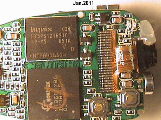

First, let me say "brilliant thread, thank you for all the research and explanations!".
I've had my #11 for a year or so and now the recording starts to snow-over after a couple of minutes. Early posts on this thread show the same effect as the battery voltage starts to drop. But, when I put mine on charge, the red light only persists for about 15mins, then I get the same short life again.
So, for $38 including delivery, I've sent for a #16. Did I do right? is there anything that can be done to restore the life of the #11, apart from dismantling and soldering in a new battery? It was a very sudden deterioration. up until a couple of weeks ago I didn't get the problem. Did I do something to damage the battery?
Sorry if all this has already been covered, I haven't found it.

nickchud, IMO, you did the right thing. The #16 is a great little camera that will soon be even greater!
I have a few #11s and they all suffer from battery problems one way or the other. I imagine the original developer was too optimistic about the charging times and preferred to implement short charging times instead of trying to get a long battery life. But in those days, this was new terrain.
Battery life also depends on the number of charging cycles, but I don't think this is too relevant for the #11. IMO, I believe the main problem of the #11 is the over-optimistic designed charging circuitry
Battery life also depends on how you charge your battery, thru the standard USB cable or thru the "special" cable. I would think using the standard cable is better on the battery. The "special" cable charges the battery directly, relying solely on the protection circuitry built into the battery.
I don't know if the "new" #11 or the #18 uses different charging components, but the #16 certainly does. After over 6 months of use, my original #16 battery is still going strong. After the same time span, my #11 would have already failed.
The only way to restore your failing camera is to solder in a new battery. If you can't solder, you can get away with splicing the two cables together and using electrician's tape to insulate the bare wires. When replacing batteries, it is imperative to get the polarity correct. If you invert the black and red wires you will most probably destroy your camera.

The only way to restore your failing camera is to solder in a new battery. If you can't solder, you can get away with splicing the two cables together and using electrician's tape to insulate the bare wires. When replacing batteries, it is imperative to get the polarity correct. If you invert the black and red wires you will most probably destroy your camera.[/QUOTE]
My battery in my #11 also wont hold a charge anymore. i was wondering if i made an external power supply, like the one on the first page, i could get away from opening the cam up and soldering in a new batt.?

When I ordered my #16 camera I also picked up a new battery for my old #11.
I just finished performing a "heart transplant" on the camera and all went well. Patient is resting comfortably.
I spliced the wires by cutting them a little bit longer, twisting the bare wires together and then soldering them. I then used heat shrink tubing to cover the solder joint. Charged the battery and recorded some video. Good as new. (need to reset the clock however).
Cost me $4 (US) for the battery - it was well worth the cost & effort.

Here's mine, see previous posts in this thread.

Put an end to intermitent 'buzzing' sound and/or video artifacts on #11 cameras
Hi everyone - It's been a good while since I last posted, so I thought I'd share a mod that will eliminate the annoying 'buzzing' sound and/or video artifacts, as the battery starts to run down on your #11 camera. This issue was addressed of course with the launch of the #16, but to the best of my knowledge at the time of posting, still remains a problem with #11.
As a bonus to this relatively simple fix, your battery life should be extended by around 15% (in tests), adding 6 minutes or so to your current recording time using a good 250mAh LiPo cell
The cause of these sound and video issues centres around the stock 3.3V voltage regulator fitted on the front (USB socket side) of the PCB. The IC is a 5-pin SOT-25 device marked 4A2* - the * is the batch code and will be a letter such as B D or C etc. The regulator fitted is a TOREX XC6204332 - datasheet HERE
Technical stuff :
There are two major problems with this factory fitted regulator : 1/ It has a maximum current rating of 150ma, but typically the device has to deliver over 100ma continuously and subsequently gets hot, wasting precious power. 2/ It has a high dropout voltage of 200mv (0.2V) rising to over 300mv at 100ma - this has a marked effect on the available recording time of the camera.
The replacement, a Texas Instruments TPS73633DBVT - datasheet HERE has a rated output current of 400ma, limited at 800ma. As a result it runs cool, disipating very little power.
In contrast, the dropout voltage of the TI regulator is specified at 75mv. However in practise it's much lower than this - I measured a miniscule dropout of just 26mv with a 100ma load.
The NMOS output stage and clever high frequency 4Mhz charge-pump make it a very efficient, low noise and reliable replacement for the original regulator.
I can't recommend this modification highly enough and at a cost of around 65 pence / $1 excluding shipping, makes it a very worthwhile and satifying mod. You may even be able to get a free sample from the TI website.
Yes, the regulator can be a bit fiddly to swap out if you're not used to handling surface mount devices, but after disconnecting the battery you can wrap the whole PCB in tin foil, neatly cutting out a small square hole where the regulator is. This will prevent solder splashes getting onto the PCB, as well as acting as a perfect anti-static sheild for the board. By far the easiest way to remove the IC, is to surround it in flux paste and heat the plastic package directly until the solder on all five legs melts. It can then be gently lifted off the board with a pair of fine-tipped tweezers.
You will notice from the TOREX datasheet that pin 4 is not used - NC (no connection), while the TI device uses this pin for a noise reduction capacitor (NR).
It appears that the the camera manufacturers decided to fit a 10nf capacitor to the PCB to cover all eventualities when sourcing 'equivalent' components.
If required, the value of this capacitor, circled in yellow on the third photo, can be increased in value from 10nf to 100nf to acheive a noise level of below 30 microvolts using the TI device specified here.
Have fun - Richard
