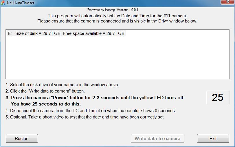

Originally Posted by Isoprop View Post
Good to hear that you are also using 32GB cards. I thaught I was the only one!
I hardly ever use anything smaller, but then I need long recording times. 32GB cards are perfect for me. Too bad there will never be anything larger that can be used in these cameras.
The only problem with this capacity, if the disk is full, is transfering and deleting the files. It takes ages, so, when copied and verified, I simply format the disk (SDFormatter is the fastest).
I never "move" files because I don't trust the OS. I once did this and the moved file was corrupt. Since then I only use "move" if the files are on the same disk or the files aren't that important to me. This happened a long time ago, so maybe Microsoft has built in some (better) verification before the original file is deleted.
Iso,
great tips .. but I must admit i MOVE No.11 and other files all the time ..mostly cause I'm lazy.. and don't like the extra delete step (tho I am doing a quick erase type format a lot more often now) ..I used to lose a lot of stuff, but So far with the picts and files off these (and the Sunglasses and camcorder cams) I haven't lost one with a "move" yet with Win 7 64bit OS.. once bitten tho I will revert to doing what you do too.. JimS

Originally Posted by empeabee View Post
W I B N I
to have a large(ish) count down from when the file is written to the camera, to when you should switch it on to get the time right?
For the chronologially challenged like me
OK, it's been almost two weeks since you posted your message, and I've been dabbling a bit... felt like writing something for fun...
Is this what you mean by W I B N I ? Maybe even a larger count down?
This is a working gimmick, extremely simple, no clock, no user input, just two clicks. I wrote this program to try and get the camera clock synchronized to the second, but I'm still having problems... I think the camera ignores the seconds. I've wasted too much time testing and have given up for the time being - maybe later...
Be warned - you may have to wait up to 105 seconds, it's just a W I B N I as you requested. Use it or forget it - yes it works Is it useful? I doubt it
Download here.
