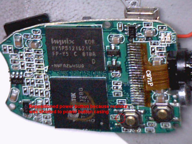

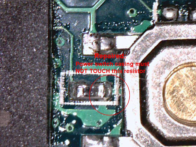

Originally Posted by Tom Frank View Post
Is this a different camera from the one discussed in this thread, or just a good deal on the same one?
Yep, see here. When PY thought he had fried his cam, his seller offered him a replacement at reduced cost.
PY later managed to repair his first camera.
It is the same (internet-shop365).
I had issue with the memory card contacts (yellow led blinking = no card). Shipping back from France to HK beeing very expensive I deal with the seller à new HD cam without accessories for 27$. Then I open the "old bad cam" and press very hard on the upper side of the memory tray and the "old bad cam" become a "good" one .
I do'nt want to remove the memory card from the "old" cam to test the "new" one .
Jacques

bricks glow red but not yellow
The yellow LED never came back on. After waiting a minute, I pushed buttons for signs of life - nothing - and then plugged it into USB, saw the red light, but could not get the yellow LED to light up. Removed its memory chip, erased the file in its root using an 808 camera. Again checked for signs of life. Prodded the reset button to no avail and concluded that I now had a test dummy with which to practice freeing up the lens before trying such things on the remaining good one.
For the record, the FlyCamOne HD was in focus right out of the box. Its problem was that hauling 60 grams of camera around with a CX2 was possible, but probably hard on its 4 in 1, so I bought the pair of 16 gram keychain HD cameras as an alternative that also afforded me an opportunity to fly a keychain HD on a Tandem in the atrium of the building where I work.
AH-64 D is offline Find More Posts by AH-64 D

Racing time and hardware design problem
My supplier, Apple, has agreed to send me a replacement cam at a reduced rate.
She thinks the racing speed (the date is advanced by 1 minute every 10 seconds) is due to hardware malfunction. Since the video is perfect, I have difficulty in believing that the problem is due to hardware. I will investigate this further…
Doing more testing, I found a true hardware design problem.
I noticed that sometimes my camera would turn off when I short-pressed the power button instead of going to photo or video mode. This was erratic. Sometimes it happened on the second press, sometimes on the 20th. I also noticed that if I carefully "levered" the USB plug the symptoms were not the same. I also discovered that there was a difference if I pressed the pointed end of the power switch or the fat end. In any case, operation was erratic.
I also discovered that I could not bring the camera into Web Cam mode.
On the underside of the board there is a resistor that is placed very near to the power switch. Under the magnifying glass it appeared to be touching the metal body of the switch. The metal body also moves very slightly if poked with a tooth pick. The placement of this resistor is far from ideal.
It was obvious that the resistor was not meant to touch the metal body of the switch, so, after removing the battery, I carefully unsoldered the 4 metal tags and moved the switch about 2mm nearer to the function switch. I should have kept the switch a bit closer to the resistor because there is no longer a distinct "click" when I press on the narrow end of the plastic cover of the power switch - or maybe I mounted the switch back-to front...
[EDIT] I have found the cause of the dull click - the switch was fluxed up! I used Q-tips soaked in acetone to wash out the flux. Now the switch is clicking like new.
However, since re-aligning the switch, I can switch between video and photo mode without any problem. Web Cam mode also works perfectly.
This rework is not possible if you do not have SMD soldering skills. You must not let the switch get hot because there is a conductive rubber inside. This will melt if it gets too hot. To desolder, I used a tiny piece of Chip Quik and lots of flux on each tag. This kept the temperature of the molten solder low. Solder wick sucked up the mess.
Unfortunately, I did not take a picture prior to the rework, but here are two pictures after the rework. As you may notice, I didn't manage to align the switch dead straight (only visible on the zoomed picture) - I'm just not so good with SMD soldering!
Interesting post. Has it affected your runaway clock?
As many don't have SMD soldering skills (myself included), would it have been possible to slip some thin plastic between the resistor and the switch rather than move the switch?
