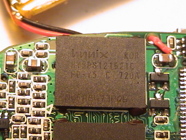

Originally Posted by Tom Frank View Post
If the USB plug is terminated like the car charger, allowing it to both power the camera and charge the internal battery, that should give not quite three times the normal recording time (120 minutes) if you start with a fully charged internal battery. All hypothetical, of course.
The USB plug on my emergency charger is terminated like the car charger, i.e. the pin4-modification. No glue is used to isolate Pin 4 and 5 in the back part of the Mini USB , instead some kind of "sticky paper" (?!) in between those pins. Pin 2 and 3 are missing in the back part, though they are present at the front part. They were probably cut off or they broke. Pin 1 is present but not connected.
See attached pic (bad photo i know, shot with a #3).

HD KeyCam v2, v3, and Jumbo?
I just got my replacement HD key cam to replace the one with the out of alignment CMOs sensor, and I find it's not the same as the original. I may not be the first one to get this one, but I'll take the time to document what is different about it... some things small... some not so small.
Differences:
1. It did not have the small "QC" stick on the side (and focus was not very good either).
2. I did the date removal firmware swap, and the yellow light did not come on to signal it was finished. Also the, non of the buttons then did anything... appeared bricked (this has been reported before). I connected to a PC USB port, the red LED lit, and I pushed the power button and it went into flash drive mode. I could access the SD card, removed the date off firmware, disconnecte the camera, turned it off and back on... Voila!... everything back to normal with no date stamp. Hmmmm... what's up wit dat?
3. I opened the camera to have a look inside (see pics of #1 and new #2 attached)"
  • The circuit board looked to have the same traces, but they were much finer defined, with some ID of various components on the board, like for LEDs, switches, etc. No date on the newer board, though.
  • The same big IC chips (memory and Video processor) on the processor side are identical, but they don't have the potting compound on the corners of the chips.
  • On the opposite "USB side, the 8 pin chip that was identified as replaceable to unbrick a camera now has an ID number on it.
  • But the biggest difference is the CMOS array. The ribbon cable is has a much different pin-out geometry on it, and the circuitboard terminations are different. And it has an ID number on it (C971P) So what is this newer CMOS, and how does it differ? More testing will be done, and I'll see if MyCameraGal can find out more.
Similarities
1. I check the video bit rate.. it was 7 Mbps like my old one, both before and after the firmware replacement. And it won't toggle into a 10Mbps mode by toggling the still pic mode before taking video.
2. I checked the battery failure file saving... it does not save the file, like my old one.
3. It still has the stop/save/continue function.
4. Webcam mode still works the same.
5. The lens appears to have the same vignetting issues
6. The colors appear to have the same low light level white balance shift. Color saturation change with light level and sensitivity to light intensity ("hunting" issue) needs to be checked.
So other than the different CMOS ribbon cable (and presumed different CMOS array), I see no other differences.
<EDIT 02/19/11> After shooting some video and comparing with my original camera, my subjective opinion is this newer version has better color white balance and is less sensitive to rapidly changing color saturation and contrast as the light level changes, which is good. On the minus side, it appears the low light sensitivity is not as good, so there's more color "noise" in indoor shots. My vendor contact has said this newer version will be all that's sold soon. <EDIT>
<EDIT 6/7/2011> Version #3 of the original #11 key cam was just inroduced, which has some revisions on the circuit board (see attached pic). Based on user feedback, the changes only affect the way the external power cable charges the camera and lights the red LED indicating charging status. Refer to the FAQs in Post #3 for more external power info.
In addition to v3, a new "Jumbo" model was introduced which is functionally identical to v3, but just has a larger internal battery for extended recording time (about 90-120 min.) and comes in three slightly different case designs (pic attached).
<EDIT 1/25/2012> A totally new design 1280x720 HD camera (named the #16) is now available. It has added many user configurable options without having to flash in new firmware. The camera's colors are also more natural looking and stable as well. See this thread dedicated to the #16 for more information.

Tom-
I did circuit board comparrison and looks exactly the same but the last numbers on my chip are 720A and yours was 707A...remember on my first cam they soldered power wire to a resistor? in your pic it looks like they tampered with same resistor...atleast it looks that way in pic...yes the array does look a bit different...
My last 2 cams I didnt need usb to remove date/time...I used SD adapter...

Yes, my first camera looked like it might have once had a wire soldered to it, but was removed. But the other wire connection point on the first camera had no such indication. Both cameras have the power connections in the same spots side by side as shown in the pics.
I don't think the numbers you mentioned have any significance other than possibly different production lot numbers. The real difference is in the CMOS ribbon cable. I have sent email to MyCameraGuy and to Omnivision (CMOS manufacturer for Camera number one) to see if they can provide any info. I hope to get some decent focusing lighting weather and video clips tomorrow.
It doesn't matter how you copy the firmware to the SDHC card (via adaptor into your PC card reader, or via USB cable). I did the upgrade with the camera disconnected from the PC as the instructions say, just like I di on the first camera, but the first one came back to life on its' own... the second one did not, until I reconnected the USB cable to access the card (to delete the firmware file). After that it has worked normally.
