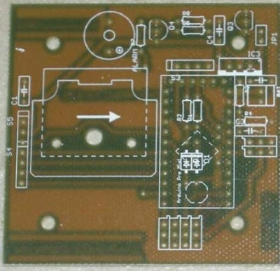

3: MultiWii early adapter boards
In the third post several first shields and adapter boards from the MultiWii are shown together.
Please note that this part is not up to date any more. In the mean time the available hardware has grown very fast.
It's not possible to maintain all the available adapter boards made by so many different users.
The post itself will stay available as a reference & may refer to the early pioneers of the MultiWii platform.
Some of the current boards are still based on these early shields.

4: Square board by JussiH (420RcPilot):
This version is available from JussiH (420RcPilot).
For now, this is the only board which supports all current functions of MultiWiiCopter.
This board can be used for a Tricopter, Quadcopter, Y6, Hexacopter & Gimbal function.
It is also possible to use a separate option for a 3.3V power supply to the sensors. More information can be found on his blog. (Link JussiH (420RcPilot) blog)
A complete step by step assembly guide is provided with detailed pictures on the blog.
The shield is regularly updated, the latest version is shown below.

Well personally I use the Lipo alarms from ebay, they cost only a few euros and serve me well.
Alex implemented the lipo alarm, i can refer to the post of Joël here He did an nice write-up about it and specifies the resistor values used.
Keep in mind that the Arduino can only supply 45mA max. on an output pin!

Of course the MicroScream: $5 Audible Lipo Alarm can also be used as alternative.

Could you also please collect the different breakout boards that are already available? If it's not asked too much...
These boards would be really helpful for beginners since it makes the assembly and soldering of the components much easier.
