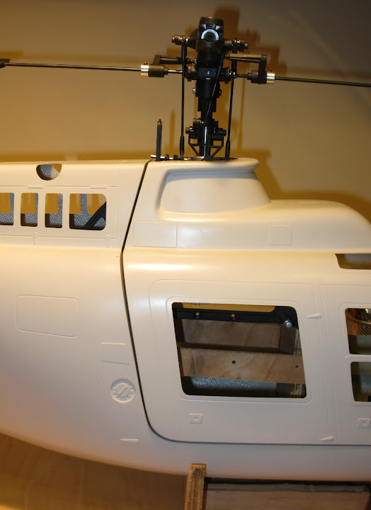

Swift in a Century 50 size Jet Ranger
Winter has come to northern Canada and a new winter project is on the bench.
I'm using a Swift NX with the following changed parts
CNE632the boom from a 620se
CNE631 Swift Belt from the 620se
CNMG509 9 tooth pinion
CNE274 650/800 motor
CNE485 HV85A ESC Electron 85/100A Brushless Speed Control

Swift
This is a training model used by the Canadian Forces

Very cool! Got one of these brewing myself . I'm sure Sidney will love seeing this build.
I am kind of curious, can I get a measurement from the floor to the top of the cowling around the main shaft? Trying to get a size comparison between the .50 size and the .30 size

Height
10 inches or 25.4 cm

Templates
Iím making templates now for the flooring and batteries and cabin mounts. Iím using balsa wood and when I get it right I will transfer over to aircraft plywood.
I plan on using two batteries in series for an 8cell power supply.
I will transfer all the templates over to a work doc as drawings
Charles

Balsa wood templates
I'm using two 4 cell for an 8 cell power supply so I'm building battery holders on either side.

Wood Work
Just setting up the alignment to hold the helicopter at the proper angle.
