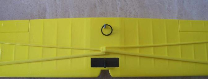

This rather brilliant bit of engineering firmly secures the wing without destroying the scale detail with the use of rubber bands or screws. Attach the preinstalled wing struts to the underside of the fuselage with the remaining screws, tighten the screws holding the struts to the wing and you're done. Just that simple.
