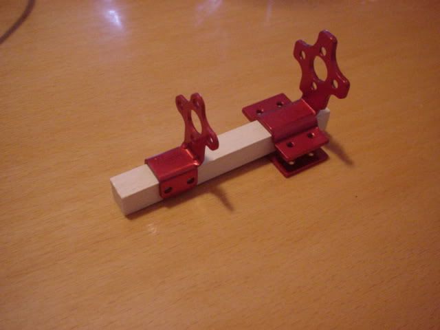

Here's dedication for ya! A day of today, and instead of going to the flying field at 0630 as usual (before it gets to hot), I am sitting at home, building...
Which motormount to choose? Decisions, decisions...
I choose the one on the right. It looks somewhat sturdier, and I do not need to drill 2 holes in the stick to fix it.
Test fit & measure.
That looks about right.
I cut the stick to size, and soaked the cut end with thin CA, so it won't split. (Don't know if it's necessary, but I prefer to do this. It's not mentioned in the manual)
Glued stick in place. The manual mentiones building up CA fillets on the motormount. I find it easiest to first glue the stick in place with medium CA, then add a few drops of thick CA and hit it with a shpritz of kicker
Some more test fitting. This time to see if I still have access to all the 4 bolts of the motormount after F8 and F9 are in place. I do...
