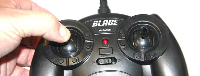

Rebinding the RTF 120 SR and the included Blade MLP4DSM transmitter.
  • Make sure the flight battery is disconnected and the transmitter is off.
  • Plug the flight battery into the 5-in-1 unit.
  • After five seconds the LED on the 5-in-1 unit will begin to flash.
  • With the 5-in-1 unit's LED flashing: Push down on the transmitter's left stick until you hear it click and turn on the transmitter. Then let the stick up and leave in the throttle off position.
  • In 5-10 seconds the receiver should be bound to the transmitter.
