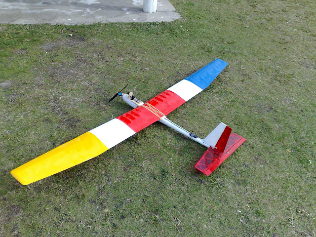

Equipment Used:
Video Tx: 1.2 ghz 800 mw
Video Rx: 1.2 GHz 12 channels
Tx and Rx Antenna: Omni
Aircraft: Condor 2000 Fuselage wing of his own design with 2.6 m env.
Engine: 1kg emmax
Propeller: GWS 10 x 4
ESC: Generic 18 A.
Lipo Motor: 2 x 3s 2200 mAh Turnigy 25 c, in parallel.
Lipo Video: Turnygy 1000 mAh 25c 3s.
Gps: 5 hz
OSD: Simple Osd Flitron.
Receiver: GWS 8 channel PPM
Transmitter: Futaba 9 CP
The Airplane
