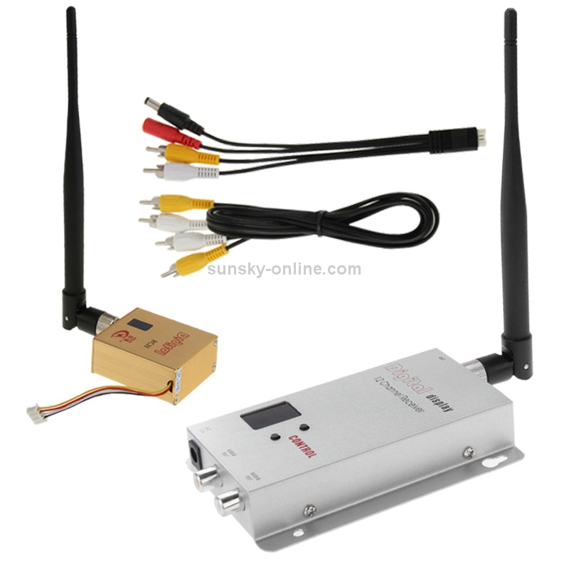

Sunsky 1.2Ghz 800mw aka Fox-800
The one with the LCD....
Price: 61.41USD + shipping (12 USD to Europe + 3$ Paypal fees)
Buy
Antenna length end to end
182mm or 7.25"
Weight
23 grams or .81oz
Many reports showing this one is very good, up to 2-3 kms Stock configuration
Real Power output: 500mw
Hints:
- Tx is smaller and is more powerful then the fox-700 See Vs Test here
- Frequency choice made with a button not a jumper
- 6-7-8 Channels seem to work the best
- Rx is the same then fox 700

Hints:
- Rx has a 17Mhz Saw filter which is good (no need to make the Saw filter mod)
Chart containing the available frequencies
Did you notice if this hint applies only to Sunsky units, or both Sunsky and BOB units?
Derek_S is offline Find More Posts by Derek_S
Old Jul 23, 2010, 09:29 AM
Joined May 2009
679 Posts
Only for the sunsky.
In fact the BoB Rx seems to have a classic SAW filter which would be interesting to mod but I di d not find someone who did it on the bob.
iacei is offline Find More Posts by iacei
Old Jul 23, 2010, 09:46 AM
Videopilot
Derek_S's Avatar
United States, NC, Charlotte
Joined May 2009
2,496 Posts
Oh, sorry I meant specifically the part about channels 6-8, but I assume that is Sunsky as well.
Maybe I should have tried the Sunsky instead of the BOB but I though they were the same at 1st.

It's fixed on 1080mhz.
I've ordered one, hope to have it in a week

Give us feedback when you test it. I think Renatoa reported it is a good one.

After shipping the Sunsky one is almost the same price as a Lawmate, isnt it? Why you get the Sunsky over the LM in this case... the extra "300mw" (if they are really there). I thought LM was about the best you can get if you dont mind 5v power. Or does LM not have the legal channels (USA)???

the lawmate is 12 volts
and is a much better video rx
all channels are available with the lawmate video rx

Where do you find a Lawmate Tx/Rx for 65USD shipped?
I had a Lawmate Tx/Rx for more then 100USD shipped and the Tx was good but a bit fragile.

Oh, sorry, I rechecked the lawmate is about $30 after shipping. But still, $30 difference for a 'better' Rx and Tx, if you dont mind 5v?
I say 'better' becasue I do not have a Lawmate, I just have asked several of the veteran FPV'rs here and ALL of them I asked told me Lawmate was the way to go. Granted they also are mosly using the 2.4 channels. And When I asked David22, he at least uses a LM RX. (Thanks David for your advice)
BUT, I also do not have a Sunsky unit. I have only 2 BOB units, which for me are working out to be a waste of money. Range just really sucks, not even counting that I am getting local interference at my favorite field (but not the BOB's fault I guess). I wish I would have tried Sunsky, as they seem to be better units. Kmart is getting 1 mile with stock omnis? JEALOUS
