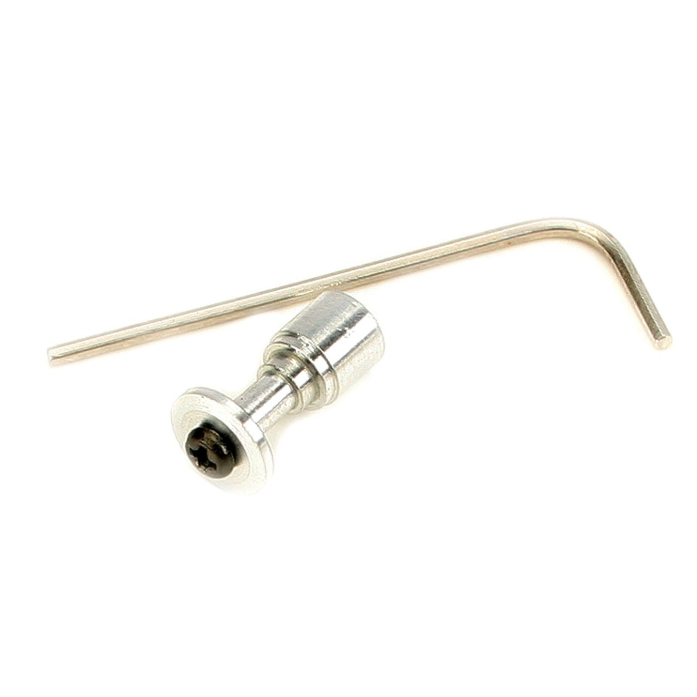

Prop adapter and GWS 5043 prop.
Here is a link for a prop adapter that will allow you to remove and replace a broken prop.http://www.rcgroups.com/forums/showp...ostcount=15053 as well as a GWS 5043 prop.
