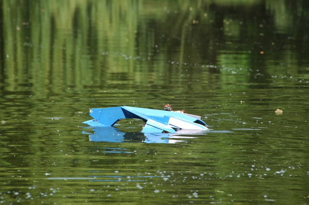

So, finally some time to test the Lippisch model! The results were..as positive as they were bad There are two design flaws, the first is that the forward hull is too small, and too shallow. I partly compensated for this by adding the two foam blocks, but a whole new hull is needed to really solve the problem. Currently, It needs full up elevator and full power, to keep the nose up enough. During acceleration you can lower the elevator, but for Take off it is always needed.
Second of all is that the stabiliser is located exactly behind the propeller
this gives you excellent pitch controll, but as long as your applying power, the Stabiliser is giving muuuch more lift, than what it was trimmed to do for. So as long as your applying power you'll need full up elevator to keep the nose level, otherwise it will nosedive. If you cut the power during flight, still giving up elevator, it will fly out of ground effect..blabla
Anyway, it is a pain to fly
But, my brother made a few nice pictures, here are some of them:
Take off, the wing is allready lifting and you can clearly see the airgap between the trailing edge and the water:
A rather crude Take off:
and a high flying flyby, you can clearly see how it looses roll stability as it ascends in the ground effect:
This is what happens if you don't apply more up elevator when increasing throttle:
And this is what happens if you don't decrease the up elevator when decreasing throttle
And finally after several rather lucky crashes:
And the rescue boat:
So...Time for a new model, a longer wider front hull, a slightly higher angle of attack for the main wing, and a much higher located stabiliser(outside of the prop wash!)
