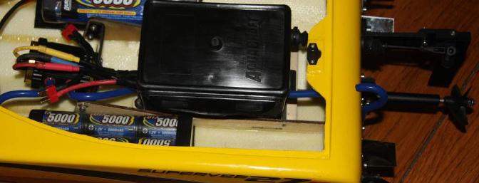

The instruction manual listed three options for the motor batteries and three different chargers. Two DuraTrax 5,000mAh battery packs with female Deans Ultra Plug connectors were recommended as providing the longest run times and best over-all performance. These were the battery packs I used for this review and they are part number DTXC2151. The Onyx Dual AC/DC charger part number DTXP4240 was recommended as the charger of choice as it can charge both packs at the same time. I used my old reliable NiMH charger and while only able to charge one pack at a time it was able to do the job for me.
The minimum size packs recommended were the Onyx 3,000 NiMH battery packs. A good middle of the road option was given as the Onyx 3800 NiMH packs and both would use female Deans Ultra Plug connectors. I used two different sets of the two packs of 6-cell Onyx 3800mAh NiMH packs in my original SuperVee 27 and they have worked very well for me.
As with the original SuperVee 27 the ESC is not designed to be used with LiPos. The NiMHs add weight that is needed as ballast for the hull. For this application I have found the heavier and less expensive NiMHs to be a very good power source for the SuperVees. On the 27R the position of the battery packs has been moved slightly forward in the hull. The new 5,000 packs read half a volt higher on my charger than do the 3800 packs at full charge. It would seem they should supply juice at a higher initial rate and for a longer period of time.
FYI: The NiMH packs worked fine from the start but they improved in power supplied after being used a few times so I run them and charge them 3-5 times before racing with them. That way I get my best performance from the battery packs when I race.

You may notice the following once you begin examining your SuperVee 27R and preparing for its first launch.
Inside the boat, you might find a small, loose 2" block of foam. This foam is intended as flotation and should be attached to the inside of the cowl. Simply use epoxy or household cement (such as Shoe Goo) to reattach the foam to the cowl.
After plugging your batteries into the ESC, you may hear a constant, steady beeping. If so, please rotate your throttle trim knob to the 2 o'clock position to start the arming process.
Reviewer's Note:
I experienced both of these conditions. The Shoe Goo worked great on the block of foam and I experienced the beeping problem after initially submitting this review and figured it out for myself.
