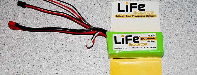

Hobbico LiFeSource 6.6V 1100mAh 10C Receiver Battery
Hobbico has just released an exciting new receiver battery to the market. This new 2s pack is 6.6 nominal volts and has 1100mAh in capacity. The LiFeSource battery is a light-weight, high-output receiver pack used to replace standard five-cell NiCD or NiMh packs.
Hobbico LiFeSource :6.6V 1100mAh 10C Rx LiFeSource Receiver battery
Battery Type:2 cell Lithium iron phosphate LiFePO4
Nominal Voltage:3.3v/cell 6.6 total
Fully Charged Voltage:3.6v/cell 7.2v total
Weight (with battery):93g 3.2oz
Size:47mm x 21mm x 11mm
Manufacturer:Hobbico
Available From:On-line distributors or your local hobby shop
Hobbico LiFeSource site:LiFeSource 2s 1100
Price:$24.99
Hobbico has released a new battery to the market that takes advantage of the latest LiFe (lithium iron phosphate LiFePO4) technology. This 2s pack has a nominal voltage rating of 6.6 volts making it perfect for today's 2.4GHz receivers and many servos. Besides the lower voltage per cell, compared to a LiPo, LiFe batteries have several other positive key differences: They have almost no self-discharge, a much longer life cycle, they hold voltage under load for much longer than other battery types ever used in RC at 3.3v/cell and they do not exhibit the thermal runaway that LiPoly cells can, so they offer greater safety.
The best news is that, with the lower nominal voltage, the LiFe pack may not require the use of a voltage regulator! Check to see that your receiver and servos can handle the ~6.6v voltage levels. Most receivers and many servos will accommodate that with ease, as it is just above that of a fully charged cell NiCd or NiMh flight pack.
With that increase in voltage, servos produce more torque and operate faster, two great in-flight advantages. The 1100mAh review pack was able to provide 11 amps of power, making it a match for even the hungriest of on-board power systems. So high-draw digital servos and 2.4GHz receivers will receive the power they need to operate at their peak. This small, light pack was able to deliver all the power needed for power hungry digital servos and receiver.
The Hobbico LiFe packs come in different sizes:
  • 2s 200
  • 2s 1100
  • 2s 1800
  • 2s 2100
  • 2s 3200
LiFeSource Batteries
All but the smallest pack also give you a great selection of connector compatibility and redundancy as well. Each pack comes with three discharge leads: one Deans Ultra terminated lead, and two leads with universal receiver connectors. The multiple plugs are also useful for dual receiver setups, and the Deans plug is great for connecting to on-board power distribution boxes used in big models. Therefore, you can choose to power the receiver with the connector of your choice. The battery also included a JST-XH type balance tap.
BATTERY FEATURES
  • Lightweight
  • High energy density
  • High output capacity
  • Small size
  • 6.6v nominal voltage -- perfect for many airborne systems
  • No regulators needed (see note below)
  • Three output leads
  • Balance leads for charging
  • Environmentally friendly
Note - Check the specifications for both your receiver and servos to be sure they can run on ~6.6v. This voltage approximates a fully charged 5 cell NiMh/NiCd pack. While this should not be an issue for most receivers, some servos may recommend only 4.8v nominal voltage inputs.
Package Contents
  • LiFeSource 1100mAh Battery
  • Instruction manual
LiFeSource Capacity Testing
I began tests with a charge to capacity. (Use the LiFe setting on your charger. You will damage this pack if you use a LiPo or LiIon voltage charge termination as those cells are charged to a higher voltage.) The instructions recommend the use of CC/CV (constant current/constant voltage) charging technique, just like one would charge a receiver pack or the transmitter.
The Hobbico LiFeSource pack only took a few minutes to top off and reach full voltage. After full charge, I discharged the pack to 5 volts using the discharge feature on my charger. This was the minimum discharge voltage recommended by the instructions. At 5 volt termination the pack had drawn out about 1050mA according to my charger.
The pack then took about 1122mA to reach charge completion. Please note that charging is not 100% efficient, and some losses were involved, but we still get a good idea of that the pack is accurate on capacity and was not underrated.
I should add that voltage drop is very steep after about ~5.7V, so charging the pack is recommended when the voltage drops below 6V.
Lithium iron phosphate (LiFePO4) batteries are fully charged at 3.6v/cell. So 7.2v is a fully charged 2s pack. In use, the pack voltage drops very quickly and settles to about 6.6v under load. It held that loaded voltage very consistently.
During the charge process, I monitored the cell balance and found this pack cells were within ~.01V of each other. It's nice to see that Hobbico used the JST-XH balance plugs on this pack, as they are common in many LiPo packs, chargers and balancers.
Another great feature of this pack is the anticipated lifespan. Hobbico reports discharge/charge cycles at 1,000, so this pack should provide many years of in-flight service. I found the LiFePO4 cells exhibit very low self-discharge, so they are ready to go when you are!
LiFeSource Connectors
The LiFeSource pack comes with three separate discharge wires. Two of those are universal receiver connectors and one uses the Deans Ultra connector. Each of the Rx connectors is rated to 5 amps maximum discharge and the Deans Ultra will exceed the pack capability. There are several receivers on the market that support high-power connectors, and I suspect more will in the future.
You can also see that the LiFeSource pack also contains a welcome JST-XH type 2s balance connector. This will help to keep both of the cells in proper balance while charging.
Flight Testing
I choose my recently reviewed Great Planes Sequence F3A pattern ship for some in-flight testing with this pack.
The use of built-in battery eliminator circuits in ESC's may not be up to the task of providing power for our power-hungry airborne systems, especially as in use with larger airplanes. The LiFeSource pack can also be used in projects were a large number of servos are used. Again, with 11amps of current capacity it is easily capable of providing power for the most power hungry servos.
The LiFeSource battery is a great solution for glow airplanes as well. The pack is smaller and lighter than most four-cell NiCd setups. I also really enjoy the servo speed increase you receive from running at higher voltages.
I have used the LiFeSource pack in another large model with four power-hungry digital servos. With the use of a in-flight servo meter, I was able to measure in-flight amp draws of roughly 3.2 amps. This draw is well beyond the current handling ability of most linear mode BECs. With the LiFeSource battery I have no power concerns in my high-draw setups. I really enjoyed the simplicity of using a single battery for power rather than running both a 2s LiPoly and voltage regulator.
The Hobbico 2s LiFeSource 1100mAh battery has been a welcome addition to the hangar. With the lower voltage of the LiFePO cells they can be used, in most cases, without the use of a voltage regulator. So it is an excellent, high-power option for applications in which a five-cell NiCd or NiMh pack, or a 2S LiPo (with regulator or BEC) might have been used. Check to see that your servos and receiver can handle the 6.6v nominal voltage level.
I was very impressed with the new LiFeSource 2s 1100 pack. It consistently delivered voltage without any complaint. It maintained voltage very well, even under load.
The battery also comes with a wide array of factory installed output connectors. It came with three discharge leads installed at the factory. Two of those leads included universal receiver connectors. This offers excellent power input redundancy, as you can plug both leads into the receiver on separate ends of the power bus in unused channels. The use of both connections also offered another benefit, input redundancy. Each universal receiver connector was rated at 5 amps, so using both allowed a safe 10 amps of power to the receiver bus.
The LiFeSource pack also included one high-power output lead. Since a number of receivers on the market today also come with high-power input options. The included Deans Ultra output lead can also be used for receivers that support that. You could certainly change that to the connector of your choice as well.
I was also very happy to see the 2s JST-XH type balance connector factory installed and ready for use. This gave an assurance that the pack will remain in balance while charging.
The LiFeSource battery has performed flawlessly in several applications. It provided the power needed and gave confidence that the receiver would be well above safe input voltage. I also liked the fact that in a couple of my large twins with multiple servos, I had no worries about overtaxing a voltage regulator or BEC.
The LiFeSource makes a simple no-frills solution that provides your plane's electronics, including digital servos, with the power you need. The LiFeSource packs come in various sizes ranging from 200mA to 3200mA, so you are certain to find with the capacity and power output for your unique application.
