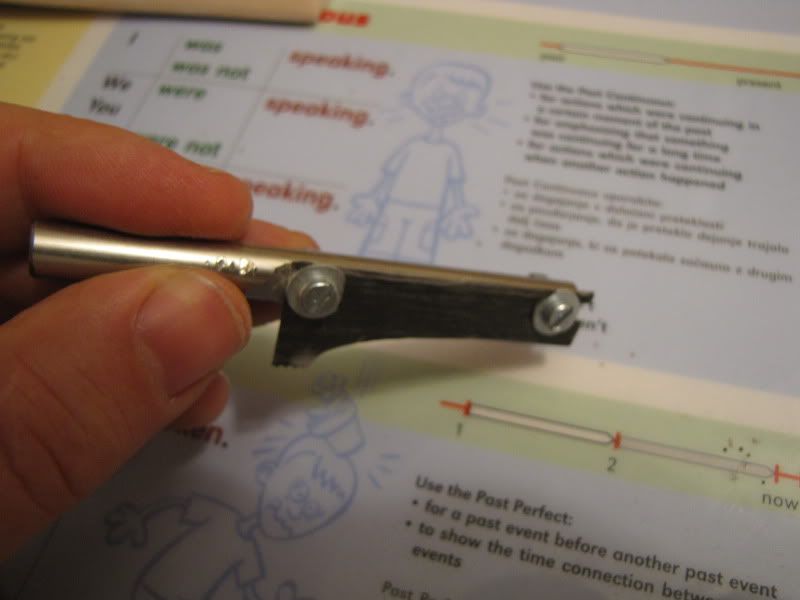

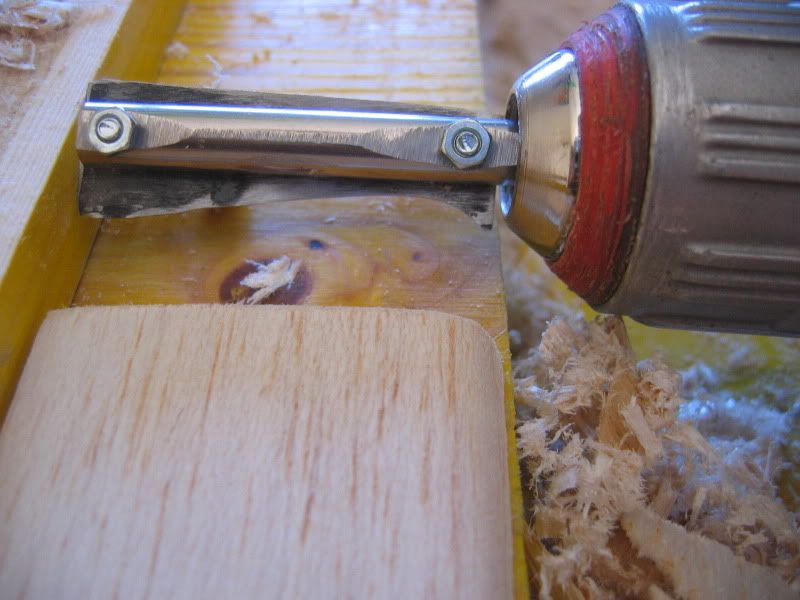

Testing the solid balsa carving:
Initial test...not yet the proper foil section....
Proper tool
Result of testing proper tool. Upper surface made by a tool, bottom surface sanded by hand.

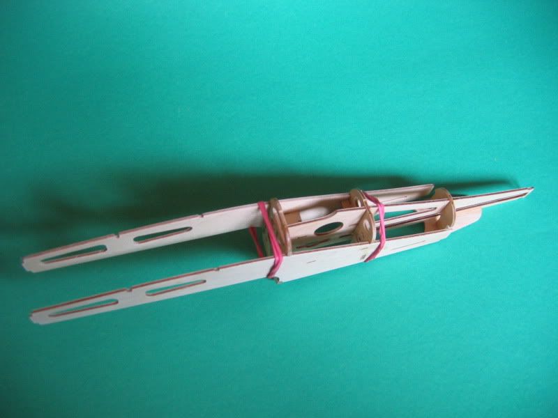

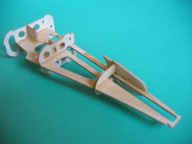

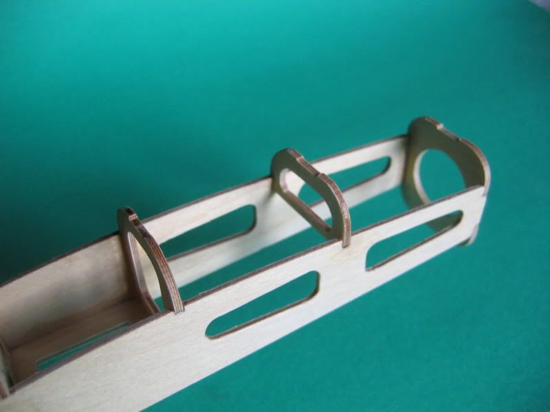

Fuselage assembly:
Plywood parts..birch.
Fuselage basic structure assembly...
Fuselage sides glued to the rear part and main former.
Front end formers...belly up view.
Tail boom placement (temporary inserted.. it will be glued later in the assembly process)
Basic fuselage structure finished. Testing of the RC equipment to fit....

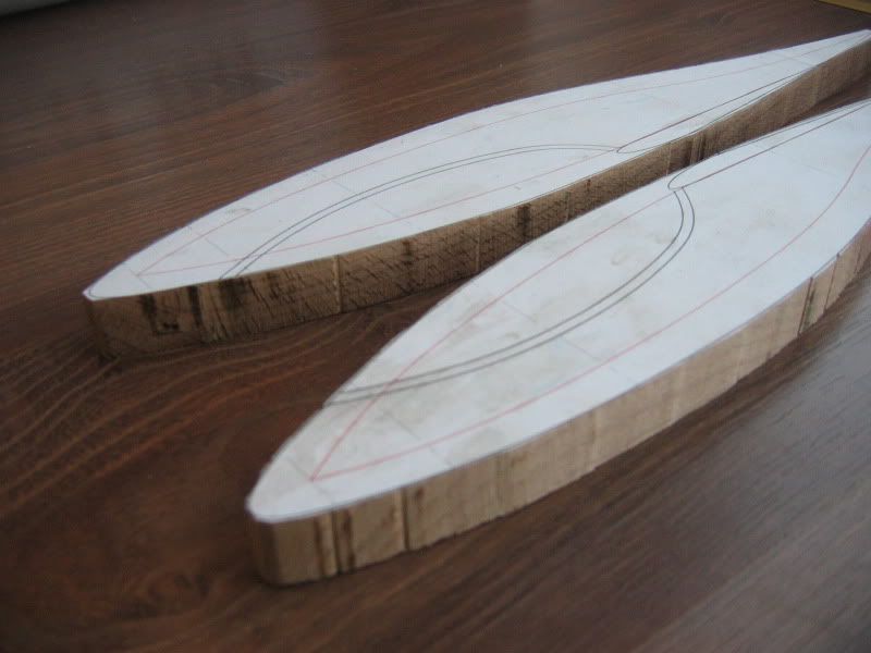

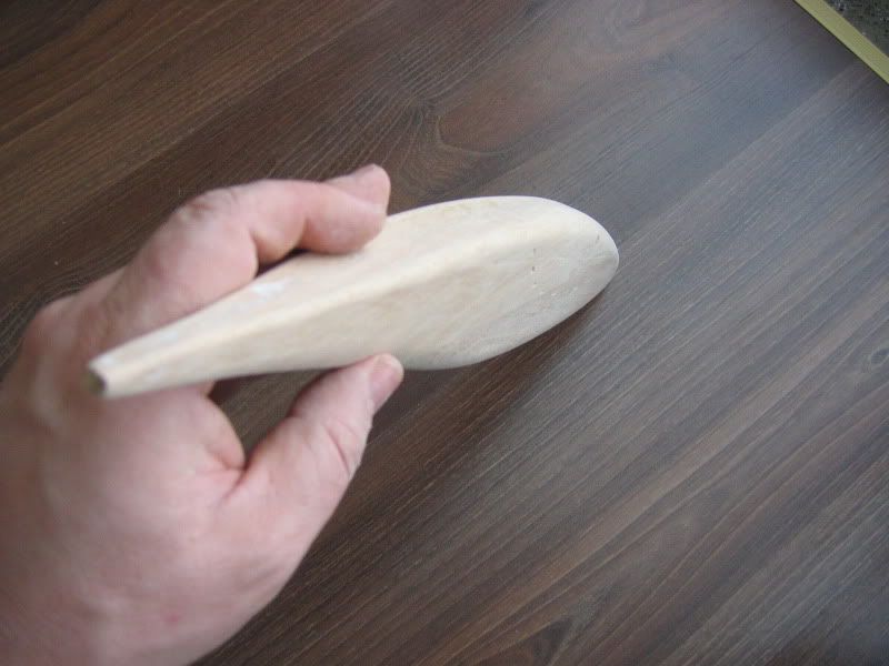

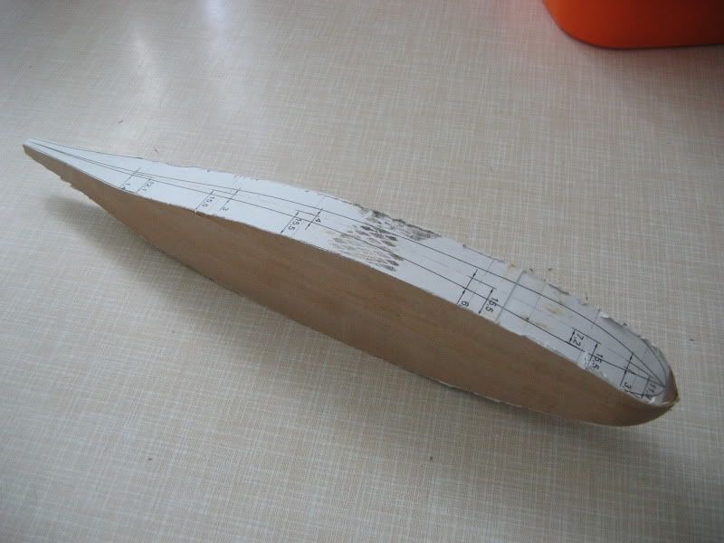

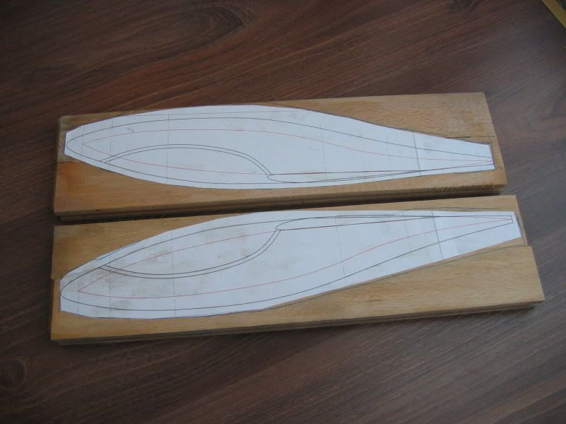

Front fuselage part plug.. making :
Hardwood blanks with a fuselage template.
Cutting on the bandsaw.
Smoothing out on the bandsander.
Bandsawing the sides of the plug.
Sanded on all four surfaces.
Rounded edges, and sanded.

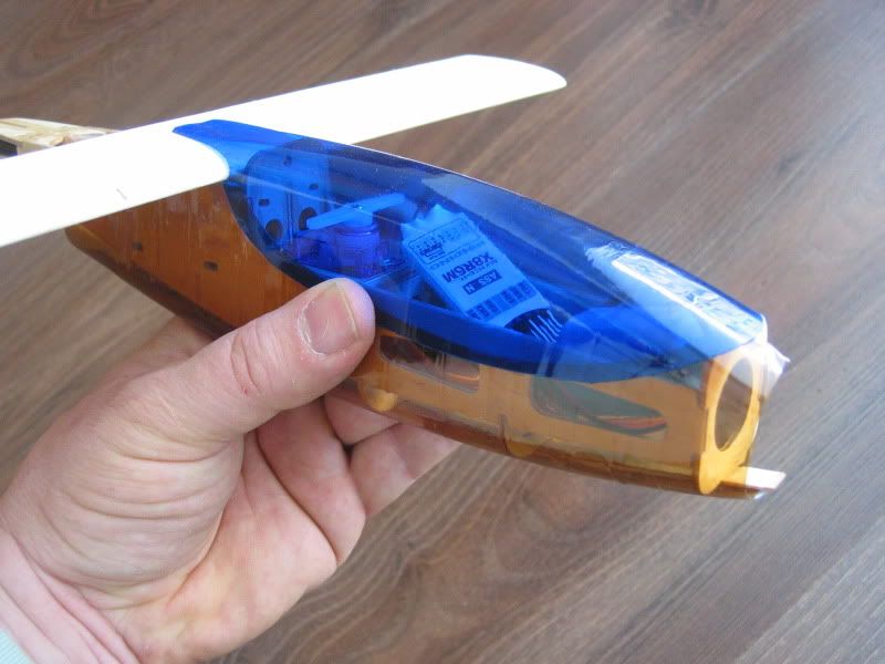

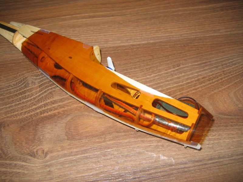

The canopy cover and side fuselage shells will be vacuum baged, but as I have not yet made wacbag box, I decided to test my plug using well prooven plastic bottlemethod for making test parts.
First I made a blue canopy:
Test canopy made.
Then I made a piece of side shell. It came out shorter, as the bottle was not large enough. But for the test of plug and test fit of the shell to the basic fuselage structure, it was enough.
Fuselage shell. Fits well.
