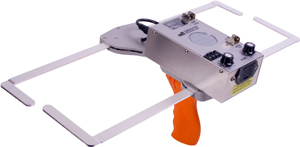

Ok here's what I found out.
My were in an tests were in a suburban environment with a lot of trees and houses.
My tests were on the Com-Spec low power unit and the FM Kit ELT.
Both units are about the same weight and the transmitters are roughly the same price.
The huge difference is you can receive the FMKit ELT with a relatively cheap Family radio receiver. The Com-Spec you need the Com Spec receiver or something receiving in the 1.25 Meter band.
Both transmitters seem to have about the same range, about .5 miles in a heavy suburban environment. Huge difference if you can gain some altitude. Find a Hilltop or a tall building to get an initial fix. I was able to get a signal out to about 3 miles from a 900' hill.

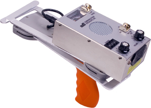

Hands down if you have the Com-Spec receiver it is a lot easier to locate your beacon. Two reasons. It has a built in very directional antenna and the transmitter puts out a ping about every second. It's very easy to adjust gain from far, near and close with a speaker, volume control and indicating needle.
The whole idea behind body blocking on the cheap FRS Radio was a real pain. Difficult to tell direction. Another problem with the FMKit ELT is that it only transmits at 25 second intervals. Trying to use the body blocking technique with such a long pause between signals is bothersome.
The reducing tones on the FMKit ELT does work nicely. At .5 miles you just hear the one tone. At 1/4 Mile you hear the two. 1/8 Mile you hear the three. and when you are real close you will hear all four.
I think you should forget about the body blocking technique and just drive 1/4 mile in one direction and see if you pick up any additional beep or loose the one you had. Perhaps a Yagi antenna would help greatly but then you are starting to add cost to the FRS Radio.
With the Com-Spec receiver finding the right direction is pretty easy just point and shoot. When the signal is really faint or if there is a lot of metal abound you may get a ghost image 180 degrees from the correct direction. With a little practice you can alternate between 0 and 180 degrees and tell which is the cleaner signal.
You can also use the BNC antenna connector on top of the Com-Spec receiver to use a different antenna. A yagi on a paint roller pole works nicely.
Another advantage of the Com-Spec beacon is it comes in a crash-proof, water-proof case containing the battery and it last for 1 month !! on a single CR2032. And they sell them for $ .50 each. With the FMKit you've got to figure out a case and battery.
If you can handle a little extra weight and cost the Com-Spec High Power Beacon is another option. It has probably 2 to 3 times the range, the battery lasts 7 days.
The thing about the Com-Spec receiver is it is part of your ground gear and you can't loose it. Although it's expensive it's a good piece of equipment. A couple guys could go in on one and that would greatly reduce the cost.
Both beacons have their advantages/disadvantages it's up to the individual pilot where they fit into the spectrum.
I've tried to be objective with my opinion and I hopes you guys out.
I haven't had to use it for real but now I'm flying with the Com-Spec because I've bought the bullet.
If you can't afford that option I would suggest the FMKit beacon. It may not be totally convenient but the difference between having it or nothing is huge !!
Best of luck, Happy Flying !!
Steve

wow! that thing looks like it escaped from 60's sci-fi movie!
