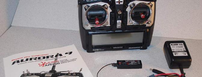

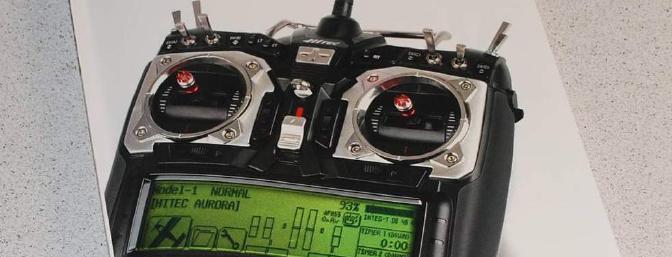

This transmitter has a familiar, but modern look. One undeniable feature that dominates the bottom of the transmitter is the large 5.1" touch-screen, backlit display. The Aurora 9 case is black with attractive, chrome gimbal surrounds.
The Aurora is extremely comfortable to hold and has large rubber side and rear grips. The stick gimbals were smooth as silk, which was no surprise since each one is double ball-bearing supported. The gimbals had firm spring tension, my preference. If you wanted to adjust spring tension it’s an easy task: Simply remove the rear rubber grips and adjust the spring tension screws now accessible from holes left when the grips were removed.
With the short transmission antenna, and the 2.4GHz module, it has a bottom-heavy balance point when using a neck strap. It would have been nice to see the Aurora balance properly when using the short 2.4GHz antenna since most users will likely be using the 2.4GHz module with its short antenna. Use of a light 2s LiPo in the place of the 6 cell NiMh pack helps the tail-heavy balance a tiny bit. To address the tail heavy balance point Hitec has released a new neck strap balance for the Aurora.

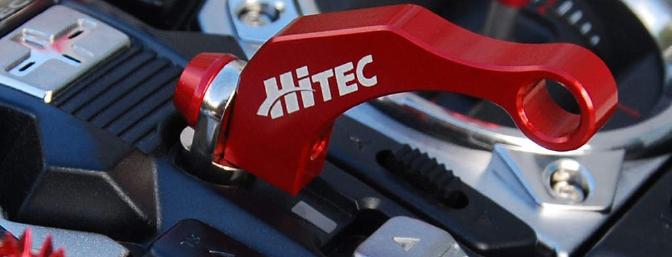

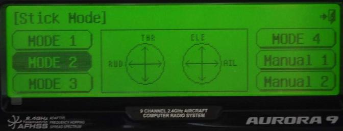

The sticks have heavy knurling on the knob top and stick lengths were adjustable length. The switches, sliders and trim buttons were comfortably placed, easy to actuate and were well labeled.
The switch tasks are 100% user assignable... excellent! The Aurora 9 has eight switches, one momentary (trainer), five 2-position, and two 3-position. The Aurora also has three separate digital trim switches: LT, CT and RT for assignable use.
The Aurora 9 also includes sliders on the top right and left sides of the transmitter case. These operated smoothly with a pronounced ratchet that allowed precise actuation. I did find they were located in a position that caused me to unintentionally bump them while flying.
The power switch is situated well away from the joystick trims. The trim levers are digital and were intentionally placed slightly off stick centers just where you’d expect them. The program screen is located across the bottom of the Aurora 9 case. This large, 5.1 inch display was very easy to read and use. The icons for model settings, trim settings, broadcast indicator, transmitter power and timers were large and easy to read as well.

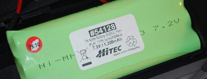

The North America version of the Aurora 9 transmitter includes a 120-240 volt six cell (transmitter) and four cell (receiver) wall wart type charger. Do not use the more common eight cell transmitter charger with the Aurora 9. This will be made easy since the charger uses a smaller ~2.5mm connector.
The Aurora comes with a standard six cell 1300mAh NiMh battery. This included charger should not be used if you switch to 2s LiPo cells. The Aurora has an internal diode, so battery cell maintenance discharging is best done outside radio charge jack.

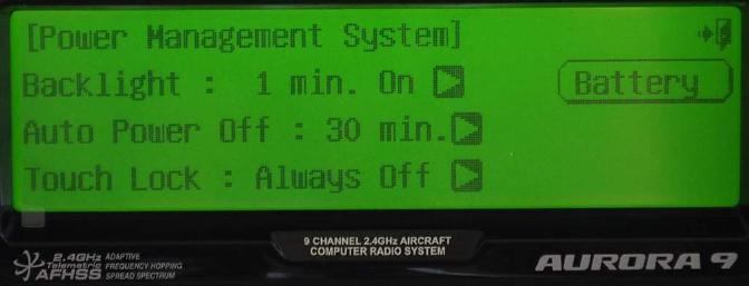

The Aurora includes sophisticated power management settings in the software so the user can set screen backlight times, auto power off settings, battery type and touch screen lock.
Users can set the backlight setting to:
  • Always on
  • Always off
  • On for 10 seconds
  • On for 20 seconds
  • On for 1 minute
  • On for 10 minutes
  • On for 30 minutes
  • On for 1 hour
One reason Hitec used a less common six cell NiMh pack was that it enables the radio to support the use of a 2s LiPo pack since the voltage levels are similar. The sophisticated Aurora software even allowed me to change the voltage setting and alarms for either the included six cell NiMh pack or a 2s LiPo. Offering excellent versatility and the advantages of high capacity, low discharge LiPo packs is a heads-up play, Hitec!
I switched from the stock six cell NiMh pack to using a 2s 1500mAh LiPo for quick charging. I also like the fact that LiPos have very little self discharge, so they are always ready for use. Charging of LiPo batteries should be done outside the transmitter case.
Worried about over-discharge of a LiPo pack? Don't be. The software also allows you to set a power off voltage threshold, user-defined from 6.5v-6v.
The Aurora also features an auto power-off function, regardless of battery type. This enables the Aurora to power itself off when it senses that you are no longer using the system by monitoring switch or stick movement. I have used this feature on other radio systems, and it is a welcome feature. Admit it, we have all inadvertently left our transmitter on. This feature alone can save the cost of a replacement battery pack.

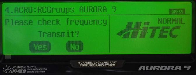

When the Aurora 9 powers up it welcomes you by name (once you set the owner) and then asks if you want to transmit. It was nice to be able to use the system without sending any RF signal during programming. A large icon on the main screen indicates if the system is transmitting.
When you are done with setup programing and want to start transmitting, you simply press and hold the transmit indicator icon on the main screen. The system then asks if you want to begin transmission. This feature, wisely, does not work in reverse and avoids accidentally stopping transmission.

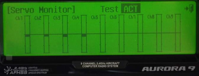

I also appreciate the inclusion of a servo monitor. Monitor feature is something used when setting up new models. It was really nice to be able to see what servo movement the programing would evoke. Since the servos are not even plugged in you no longer have to worry about stripping gears or bending linkages, and yes I have done that.
The Aurora supports running the servo monitor screen in test mode. This allows the system to automatically scroll through full input cycles of all 9 channels without having to manually stir the sticks or switches. Nice.

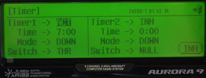

Another powerful feature of the Aurora has is the robust flight timer setup. The Aurora supports two timers per model with up or down timing functions. The timers are user-definable for a specific switch or throttle stick activation.
I use throttle stick timer activations. The timer start point can also be set based upon a specific stick advancement point. The timer starts when you reach that throttle setting and stops when you drop below that preset condition... excellent. This is an awesome feature for me, the guy who always forgets to start the timer!

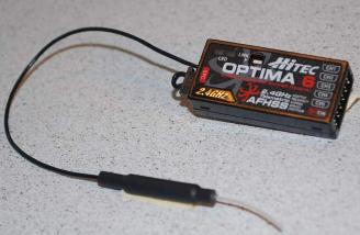

This particular review package came with the Optima 7 receiver. The Optima 7 receiver is a full-range, end-plug receiver that was compact and light.
Interestingly, to keep the receiver in the slim format case, the Optima 7 has plugs on both ends of the case. I really like this feature as you can plug throttle into the front side of the receiver making wire runs and installation neater.
I found the Optima 7 was easily able to fit in the tightest of applications.
Just like the Aurora 9 the Optima receivers also have sophisticated feature functionality.
The Optima receivers include an industry-unique, Single Boosted Omnidirectional Antenna that Hitec calls BODA. This antenna transmits telemetry data back to the transmitter for real time, in-flight data access. Today this includes monitoring the receiver voltage status, showing the power output of your on-board flight pack, regulator or BEC. The Aurora 9 sounds a low voltage alarm, warning you if the airborne battery was running out of power.

Hitec Optima 6 Receiver
Hitec also offers the smaller, lighter Optima 6 receiver. The Optima 6 receiver is full range, and it can be used in any size or type of aircraft where 6 channels is adequate. It features the BODA antenna but has more limited upgrade options without the inclusion of data port for the telemetry module and data firmware updates. The Optima 6 does support receiver voltage telemetry.

Power down - Range test
The Aurora has a range check function that can be used to check your individual setup for potential installation issues. This power down option should give a usable range of about 100 feet or 30 meters. I was always able to get well more than 100 feet away, and actually have yet to find the range limit in power down mode. In power down mode the transmitter will constantly emit a very loud alarm, reminding you that it is not safe to fly.

The throttle stick timer activation is an excellent feature. I will never forget to "start" my timer again since it now operates using the throttle stick. For night and dusk flying the backlit display is very welcome.

Here's a shot of the battery management screen that will be in firmware V1.07 which allows the user to set a custom low voltage warning per model as well as the ability to see the lowest voltage realized during the flight. If flying an electric model you can tap power off the main flight battery (up to 35V) and plug this directly into the SPC which not only eliminates the chance of the BEC causing a brownout, but when setting the low voltage warning, you can fly as hard and as long as you want/can until the warning goes off with no worry of unexpectedly having the ESC cut power to the motor when the battery dumps.
Mike.
