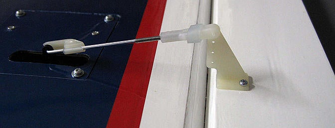

    The wing halves come with the ailerons already hinged. Follow instructions, and use thin CA to glue in the hinges. The aileron servos install on the underside of the hatch covers. I first used a servo to verify the mounting block locations, then used epoxy to set them in place. These blocks are reinforced by external screws. Whenever wood screws are used, the manual recommends that you put in the screw, take it back out, wick some thin CA into the screw hole to toughen it, then reset the screw when the CA has set to prevent loosening from vibration. I recommend taking the extra time to install your screws this way. It creates a much more reliable airplane for the long haul. Finally, I installed the servos to the hatch covers.
    I plugged together the servo extensions and secured the plugs with large heat shrink tubing. I used the strings to guide the servo wires down the tubes to the wing roots and then installed the hatches with attached servos.
    Next, I installed the aileron control horns, noting that the screws DON'T go all the way through the aileron! I drilled the pilot holes carefully into the hardwood blocks. I fit the clevis to the pushrod, made a 90 degree bend at the servo location and installed a Faslink to attach the servo end. I slipped a silicone clevis retainer over the clevis to keep it closed.

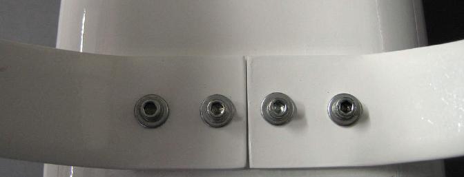

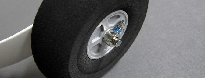

    Landing Gear
    I attached the axles first and cut them to length according to instructions. Next I installed the wheels after grinding a little flat spot on each axle where the wheel collar screw hits (use thread locker on the set screws). The wheel pants bolt to each half of the landing gear. I recommend you run the screws into each blind nut to make sure they thread in easily before assembly. There was a little "fuzz" in some of the holes. Follow the steps in the manual to attach and align the wheel pants.

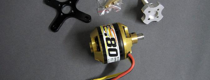

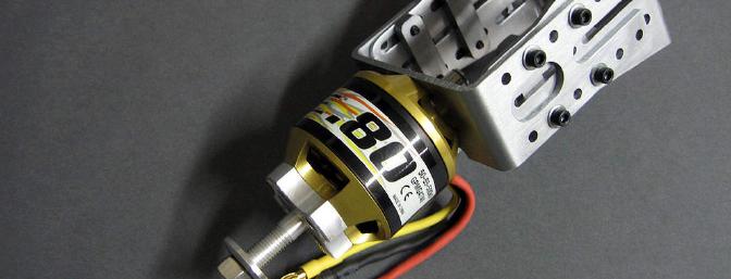

     Rimfire 50-55-500 (.80 Equivalent)
    Type: Brushless Outrunner
    Number of cells: Li-Po 5 – 6 cells
    RPM/V: 500
    Weight: 268g
    Shaft Diameter: 8 mm
    Power Ratings: Continuous Amps 52, Surge Amps 65
    Max Power(watts): 1154W Continuous, 2200W Burst
    Recommended Props: 15 x 6 to 15 x 8

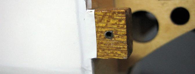

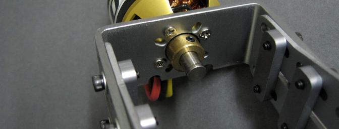

    The motor installation comes next, and there are instructions for glow or electric. I’m building an electric version, so I got out the motor, motor mount and screws. I attached the prop adapter using the included socket head screws and thread locker, then bolted the motor to the front of the mount carefully and removed an extra mounting bracket that would not be needed in this installation.

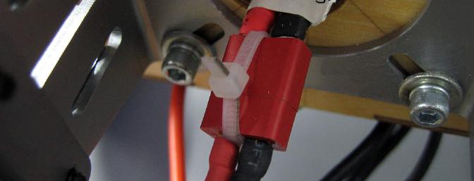

    I installed the ESC to the underside of the the plywood motor mount box with 3 wood screws. I cut off the extra length on 2 screws because they stuck up into the battery tray area.
    No extra cooling holes in the firewall are needed, so I proceeded to the motor mount installation. I simply attached the mount with the proper bolts and thread locker. At this time you may want do a preliminary Center of Gravity check, to determine if the receiver battery needs to go up front, or somewhere near the receiver. Mark the proper CG on the wing as described in the manual, assemble the plane, tape on the cowl and loosely installe the prop and spinner. Rest the 2 batteries in the tray, put the hatch on loosely and picked up the plane at the CG. If the tail hits the bench quickly, it needs the receiver battery in the nose. If the nose drops with authority, the receiver battery will have to go further back, perhaps next to the receiver where space is already provided. My installation needed the receiver battery in the nose, so I put it on the motor mount. This did require me to put the flight batteries at the back of the battery tray to balance. I secured the receiver battery with cable ties.
    The battery leads will just be long enough when the “Series” adapter is plugged onto the ESC leads. I used a cable tie to secure the ESC power leads to the Series adapter since it is hard to reach if it came unplugged. In the future, I may get a longer series adapter, or add 2" of wire to the ESC battery leads for easier flight battery attachment.

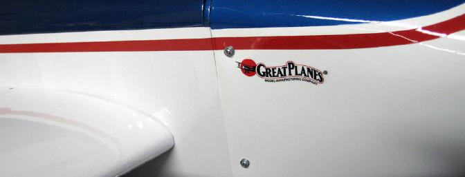

    Cowl
    I followed instructions carefully to measure the location of the cowl screw holes so they hit the center of the mounting blocks. I installed one screw at a time and adjusted the cowl to stay perfectly centered on the spinner. Remember to harden the screw holes with CA. After the cowl was installed, I reamed, balanced and installed the prop and spinner.

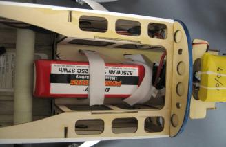

    Battery Installation
    I slid my batteries onto the battery tray, and noted the position. I attached the canopy, and then performed the final CG check. Since I had installed the receiver battery in the nose, this required a rearward mounting of the flight batteries. To reach the marked CG position, I found that the batteries had to come all the way back to the spar. I installed hook and loop fastener on the battery plate and batteries, then routed the long hook and loop strap around the batteries through the provided slots.

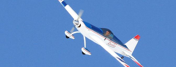

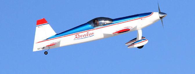

    Our flights were done in the dead of winter. The first day the breeze was mild, so the Revolver tracked smoothly along the pavement with little rudder correction. Rolling on the power gave very quick acceleration to flight speed, and low rates yielded a smooth takeoff. About 3 clicks of elevator and 2 of aileron got it flying straight and level. Even on more windy days the Revolver tracked along nicely.
    The .60 Revolver has a 70" wingspan and the trim markings make it very easy to see in the air. On low rates it is quite docile and requires full use of elevator to change pitch quickly. In fact, low rates are very low, and I preferred going to high rates for most maneuvers. I think I will settle on slightly more throw for low rates and slightly less for high rates.
    The Revolver tracks smoothly along pavement on low rates and accelerates quickly. To lift off, I applied a little up elevator, and it climed out nicely. Landing requires some planning, as the plane is very clean aerodynamically and wanted to keep flying. I found that leaving the prop brake OFF helps the plane slow down nicely for a landing. Leave on a tad of power until you turn onto your base leg, then throttle back and let the prop windmill. The plane still comes in with a fair amount of speed and a good glide. Settle in just above the ground and slowly feed in elevator until the Revolver settles onto the main gear. Another technique that works well is to have the prop brake ON, but apply a couple clicks of throttle trim until the prop turns over slowly at low throttle. This allows the prop to windmill at low throttle, yet the motor will respond instantly to throttle if you need it.
    This is a very smooth aerobatic plane on low rates. With 111 W/lb. available, loops are as big as you want with excellent vertical power. It retains energy well through maneuvers, not slowing at all on the downside of loops.
    After some flight experience, I added another 10% of throw to both directions on the elevator. This gave it a much quicker response on High rates that matched the rates on the ailerons and rudder well.
    Rolls are pretty quick and close to axial. Slower rolls need timed elevator to stay on line, and really slow rolls need rudder as well.
    Spins require high rates and can be done at moderate altitude. The spin stops soon after you release the sticks, but requires some timing to stop in a precise spot as inertia carries it around a bit further.
    Stalls are hard to induce with low rates. High rate elevator usually causes the nose to drop straight ahead, where a burst of power will get it flying again.
    Knife Edge is very easy at high speed. It pulls a tiny bit to the gear with the right wing down, hardly enough to mix out. Knife edge with left wing down is just about perfect with no noticeable coupling.
    Inverted flight is very easy with about ¼ inch of forward stick required to keep it level.
    Stall turns are a piece of cake with the very effective rudder.
    This plane and motor are not really intended for hovering. It will hang on the prop but there is not enough power to pull it upward. Recovery to forward flight in any direction is easy though.
    The Revolver snaps nicely both inside and outside on high rates. A bit of practice lets you stop where you want.
    A nice feature of this Electrifly ESC is that when low voltage cutoff is reached, it pulses the throttle and you can hear it clearly. This is a very quiet power setup, so the changing pitch of the prop helps you quickly recognize ESC cutoff. The plane doesn’t really change speed as this happens, so you can fly normally as you back off throttle and set up your landing approach.
    The speed envelope is fairly wide, with moderatly high speeds down to slow, controllable flight. It handles wind gusts well, so the day doesn’t have to be perfect to perform nice aerobatics.
    The power system is nicely matched to the .60 Revolver for aerobatic flying. It has good speed and plenty of vertical power. It is also very quiet and smooth, with surprisingly good flight duration with the 3350 mAh batteries used. The batteries are light in weight and deliver full power right to low voltage cutoff. We flew in 35 degree weather so the motor was cool to the touch, and the batteries were just barely warm.

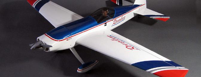

    This is a really nice airplane! It is very attractive and well built, and the recommended electric power package is matched very well with the flying characteristics of the plane. I feel good flying the Revolver. It handles smoothly in the air, yet is quite agile for aerobatics. I had no hesitation doing full throttle snaps and felt in control all the time. Takeoffs and landings are smooth and stately, although the gear is a bit stiff and will bounce if you set it too firmly on pavement. Everything about the plane is high quality. For those people that prefer glow power, no changes are needed to the firewall or airframe, and the motor mount and tank are included. You may want to fuel proof the engine area though. I look forward to many seasons of practicing and enjoying my aerobatic flying with the Revolver.
