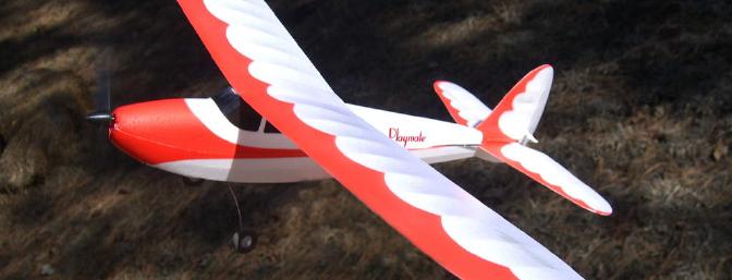

You know that feeling. It's evening as you get home, but you are just dying to fly something. Luckily, the Playmate from Flyzone is here to help! It's a great size to fly anywhere, anytime - at night, in the snow, or even both! At just under one ounce, the Playmate is a great small plane to have around for flying indoors or in your front yard. With a unique spring loaded gearbox, damage is minimal in the event of a crash, which makes the Playmate perfect for beginners learning to fly as well as experienced flyers just looking for something to throw around out front.

The Playmate flies just like its bigger high-wing counterparts. It's stable, rights itself easily and is relaxing to fly. Right out of the box, it needed no trim at all! I found it handled small amounts of wind well, but really was tossed around in winds over 6 miles per hour (but who flies a micro in that kind of wind anyway?). Indoor flying is where the Playmate really shows its true colors. The spring-loaded gearbox makes a cool sound, so buzzing the other micros becomes a common occurrence. I found my Playmate was one of the faster indoor planes at full throttle, but still flew gently and slowly with the throttle stick down lower.
Taking off and landing are just about as easy as it gets with the Playmate. With a gentle hand toss at 3/4 throttle or rolling along the ground, the Playmate has no trouble getting in the air. It is not underpowered at all, so getting airborne is easy. The Playmate climbs well and has enough power to climb out at a fairly steep angle.
With minimal throttle, the Playmate descends slowly, and gentle powered landings are no sweat. For "spot" style landings, coming in low and applying up elevator as you cut the throttle results in a nice ballooning flare, with a very small roll out. Catching the Playmate is also an option, since it flies so slowly and gently. Just remember to cut the throttle before it gets to you so you don't burn out the motor!
The Playmate is still a 3 channel micro flyer, but it isn't afraid to show what it can do:
