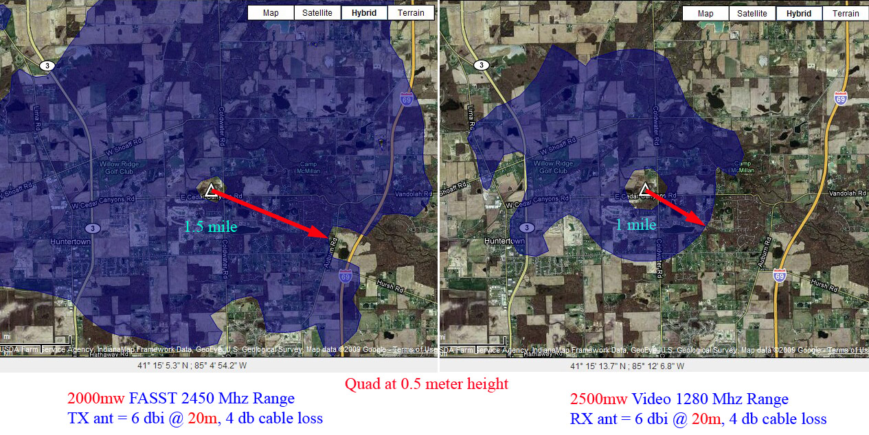

I would like to present an FPV base system optimized for Quadcopters that I have been working on for several months. The system uses standard off the shelf components. The key characteristics are:

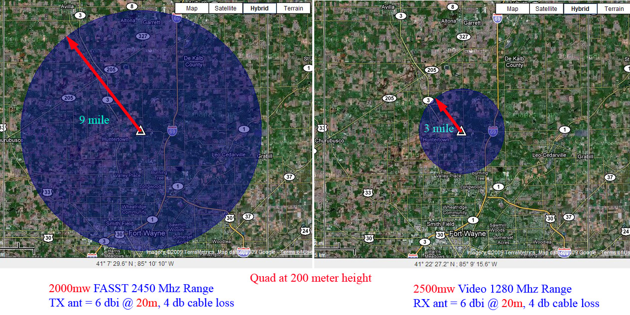

1) Omin coverage range >3 miles when flying at High Altitudes. No antenna tracking.

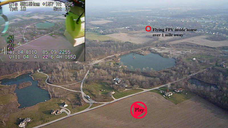

2) Non line of sight Landing coverage (0.5 meter) up to 1 mile.
3) On screen RSSI for FPV Video RX levels (both channels of diversity).
4) On screen RSSI for Futaba FASST control system.
5) Indoor base station using outside antennas with Omni coverage.
Unlike gliders and airplanes, most Quadcopters do not have the speed or flying time to go great distances. They do have the ability to hover close to the ground providing unique video and photography opportunities. The low altitude, often with non line of sight conditions, presents a control and video signal challenge unlike the high flying planes.
Although an amateur radio license is required for my particular implementation, elements of the system (like the RSSI for Video & FASST) could be useful in other FPV systems. Here is an example of a Quadcopter 1.4 miles away being controlled from inside my home via video on a large screen TV:

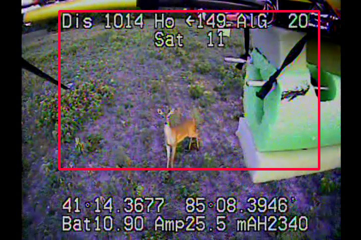

Note the two bar graph in the lower left corner of the FPV video. That is showing the signal level in dB for the two diversity receivers. The scale is calibrated such that that a signal just above the 0 level mark is still flyable. You can see that at 1.4 miles there is at least 12 dB of margin. (I am VERY conservative in my calculations).
During the development of this system I made extensive use of a Longley Rice modeling program to predict the control and video range for my local area. Here is an example showing the expected coverage for Quadcopter landings in my area:
Of course the high altitude coverage is MUCH wider:

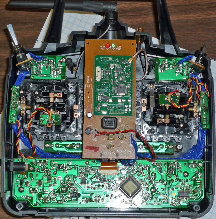

Futaba FASST TX modification for Driving 2 Watt LCOM amplifier
This modification is rather simple. After removing the battery and back cover, a cable assembly is used to provide an external connector (Gold RP-SMA on top of TX) to drive a 2 Watt amplifier:
The original U.FL cable from the mounted antenna is just rolled up on the left side in case I ever want to return to the standard configuration.
I used this U.FL to RP-SMA connector assembly so that a standard RP-SMA rubber duck could be used when not using the amplifier:
http://www.sparkfun.com/commerce/pro...roducts_id=662
A cable with a Male RP-SMA and N Male connector is use to interface the 2 Watt amp.
Here is the 2 Watt amp I am using:
http://www.l-com.com/item.aspx?id=20081

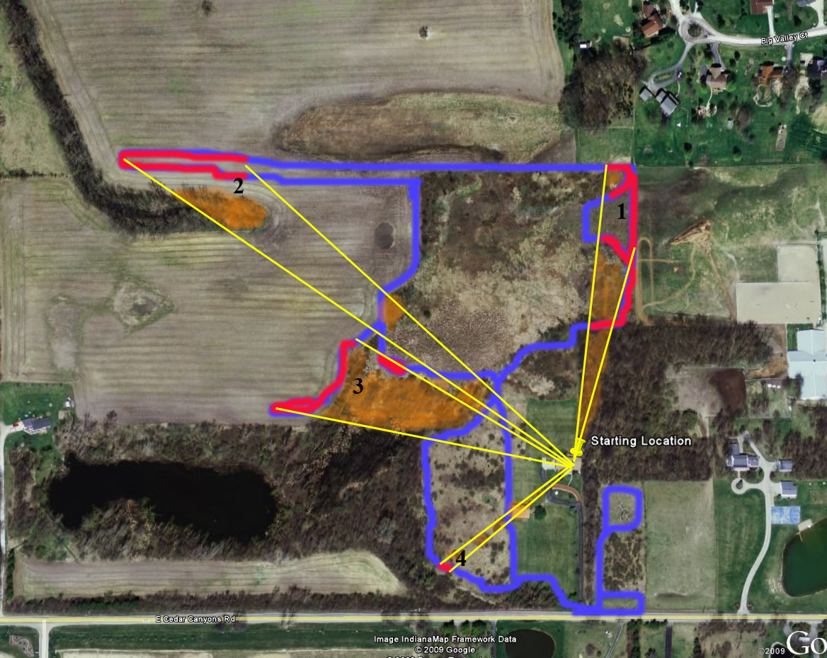

Now some may ask why have the 2 Watt amp when the standard system can do almost two miles. The reason is that 2.4 Ghz is easily attenuated by trees and the objective is to have control for low hovering even when there is non line of sight. My measurements show a reduction of 17 dB when there is 150 feet of trees blocking the signal and over 30 dB for 500 feet of trees! Here is an example of a test where the quad was mounted to an ATV and a run was made covering areas of dense tree blockages (colored yellow):
The Red area shows where the standard 100mw FASST signal dropped out. Area 1 and 3 had 300 to 500 feet of tree blockage. Area 4 had blockage by a barn and some trees. The same test run with 2 Watt amp had no dropouts anywhere.
I'm using a 6 dBi Collinear antenna from LCOM currently mounted at 6 meters just above my roof:
http://www.l-com.com/item.aspx?id=22264
The 6 dBi antenna is about the maximum gain omni that can be used before the higher nulls become a problem for high altitude flights close to home. This antenna will eventually be mounted up 20 meters on my tower to provide even deeper coverage into wooded areas.

By the way, here is the outlined area in the FPV view which corresponds to the HD camera view:
