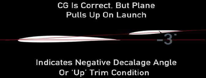

Decalage
In a nutshell, Decalage is the difference between the neutral angle of the wing and stab. Typically, high performance planes use what is called ďzero-zeroĒ meaning, the wing is at zero, and the stab is set at zero. While not all planes are set up this way, unless the manufacturer recommends something different, this is a good place to start.

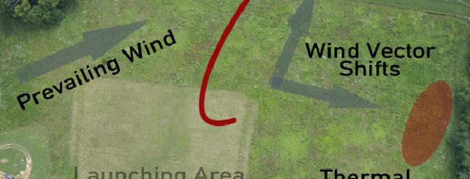

Utilizing the mini-DLG, Bruce discusses launch presets, over rotating and other effects the wind will cause the plane demonstrate. Itís up to the pilot to recognize what the plane is doing, how the wind is affecting it and make corrections as necessary.
Launch Clinic
The Perfect Launch, pushing over too late and many other launch issues are demonstrated by Bruce. Again, decalage is discussed as it pertains to launch issues.

If your thermal is behind you, you donít launch downwind, but instead do whatís called a ďturn and burn.Ē Bruce also demonstrates a second method of getting downwind which is basically an Immelman turn.

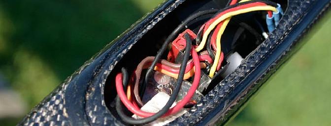

  • Installing 2.4 Radio Set Ups
  • Installing RDS Systems
