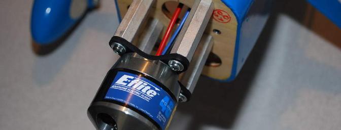

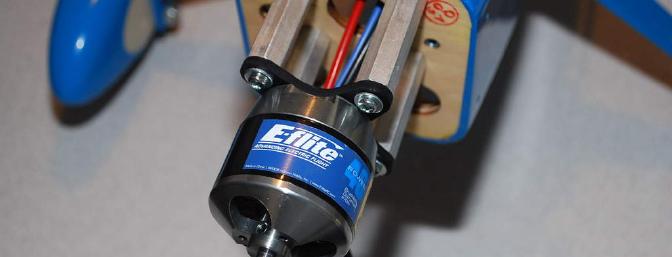

On to the nose of the beast. Electric setup was a snap.
The motor simply bolts on the the fuselage using the long bolts and long aluminum stand-offs.

The recommended Power 46 brushless motor and 60AMP ESC were used in the Toledo Special.
Amp draws
The included brushless motor is perfect for use with 4s packs. With the Thunder Power 3850 mAh 4s pack it produced the following results:
Motor statistics on 4s

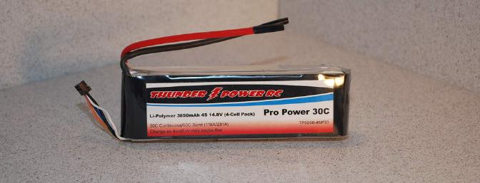

A single 4s 3850 MAh Thunder Power battery was used to provide power. This pack weighs in at 14.4oz/403g. Performance of this Thunder Power pack was stellar, and as you can see it provided great voltage under a ~39amp load. I have also used Thunder Power 3300 4s packs in the Toledo as well, and it worked very well and still provided plenty of flight time and power output.

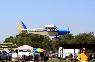

The Toledo Special is a large, attractive airplane but I was expecting very docile trainer like characteristics. I was correct but soon found that lurking inside this gentle plane was an aerobatic monster!
In-flight pics come from Ronnie. Thanks for these fantastic in-flight shots!

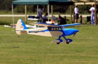

The Toledo really retains energy quite well. It’s so clean and slick that it will take a bit of space to slow down! I rarely use more than half throttle in normal flight except when doing aerobatics. It just looks at home on slow, low fly-bys!
Takeoff and Landing
The wide spread of the main gear on the Toledo gives it very solid ground handling. With the light wing loading and large wing it was airborne in a hurry. A slight nudge of elevator has this in the air with authority. It needs very little room for takeoff even on grass fields.
Landings were straightforward but be warned: The Toledo really carries energy well! It will slow down but you need some space to land this bird.
Special Flight Characteristics

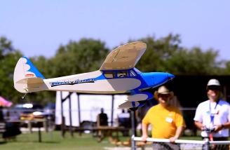

The Toledo Special is an wonderfully performing sport airplane. Do not be deceived by the "high" wing; this airplane has the character of a point it and go acrobat!
The Toledo is just simply a honest flier. It goes where it is pointed, and it travels with a great deal of style. The plane penetrates and handles wind very well.
The plane stalls very predictably for a model with a low 20s in/oz wing loading. It drops a nose but not a wing, and recovery is very quick.
Loops require full power with the 13x6.5 propeller but that is just fine with me. Rolls are slow on low rates and just look magnificent. While they are not perfectly axial, they look just right for this high winged beauty. Inverted flight requires some "down" input but not too much. It flies well inverted.
Stall turns are also a thing of beauty but still not the most fun maneuver. My favorite is pulling the nose vertically, and with the great energy-retaining ability of the Toledo, it goes up nicely! When you still have some airspeed, hit full up, right elevator and rudder, then cut power. You will be rewarded with a wicked snap that starts in the up-line and then continues with furious continuation in the down line! I can't believe it stays in one piece, but this bird snaps like a beast! Recovery is very quick even with all those violent contortions.
