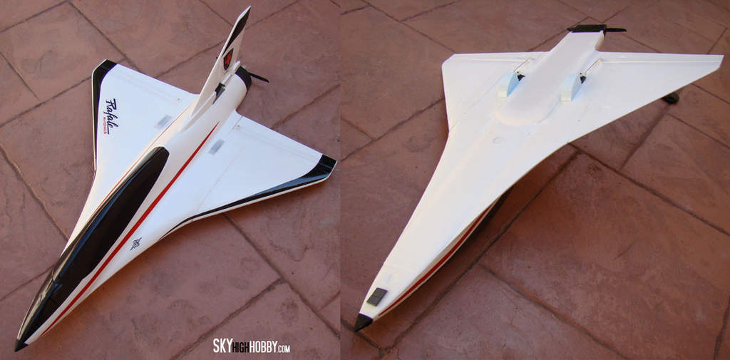

I have been working on my Phase 3 Squall. I decided to try a totally different route. I am not really interested in thrust vectoring so thought I would modify the airframe a little bit. I am going with the the 60mm Wicked 5 blade fan and the Wicked 4800 KV motor on 4S lipo. This setup makes a Phase 3 F16 go 115+ mph so though why not for the Squall.
So I have modified the inlet and outlets to run the smaller fan. See the photos attached. The inlet I cut off a large chunk of the foam to make the inlet lower. Then cut a notch in the belly pan so the foam can be bent so the belly pan is flat again. Then I cut notches on the tail cone so the exit diameter is 1.8" which is what is needed on this fan.

I am waiting for my new shipment of motors to come in. I am doing two versions, one with the new Wicked Plus 4400 and the 5 blade Wicked 60mm fan for the modified airframe, then one with the stock fan and the Wicked Plus 4000 motor. Here is the testing I got:
Wicked Plus 4000 and 3 blade rotor, after 15-20 seconds I got
51,000 rpm, 693 watts, 46.6 amps
I then put on the 5 blade rotor and got this:
46,069 rpm, 786 watts, 54.7 amps

Wicked Plus 4400, 60A ESC, 30C 2200 4S
Here is Don's set up in the Squall. It is very fast. I glassed it and painted it so I'm sure I lost some speed. Flying weight is 27 oz or 1.7 pounds. If I am getting only 600 watts that is still 353 watts per pound. Video to follow.
