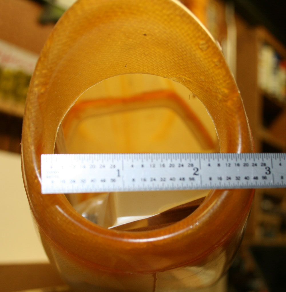

OK, back on track. Plane will be here tomorrow, I'll get pics of the air inlet for calculation purposes and post pics of all the virgin parts. Should I be worried about 27 year old balsa wood?

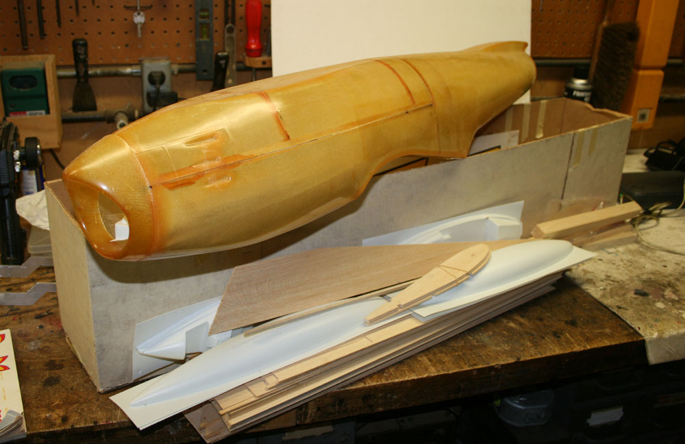

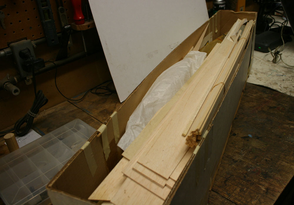

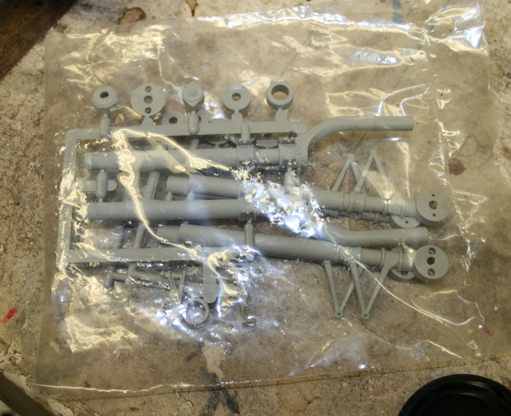

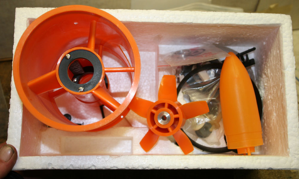

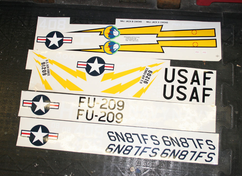

Thanks all. Its here! Its here! I just opened it up and took a quick look and some pictures. I think there might be a couple balsa pieces missing. I'll have to lay everything out later and check, but no biggy. Also I mis-read the ad, it didnt come with the .21 engine. Again, no biggy. I still feel I got a good deal and cant wait to start building with all of your input. On to the pics.

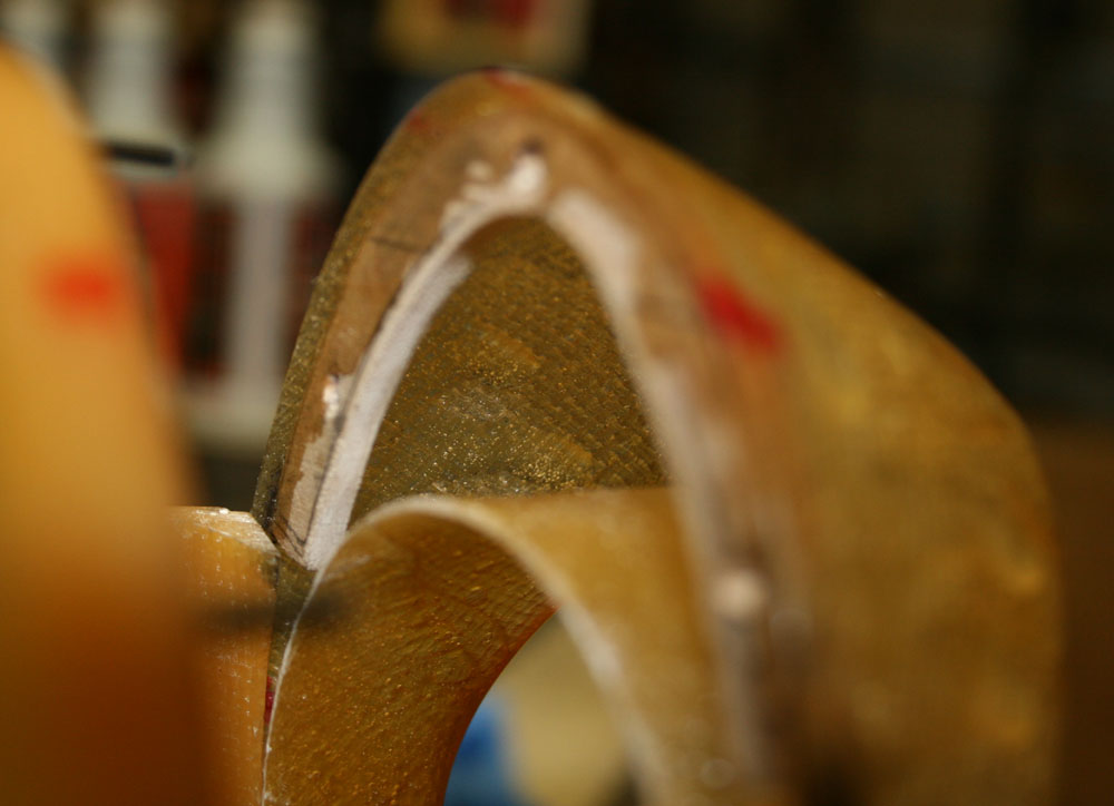

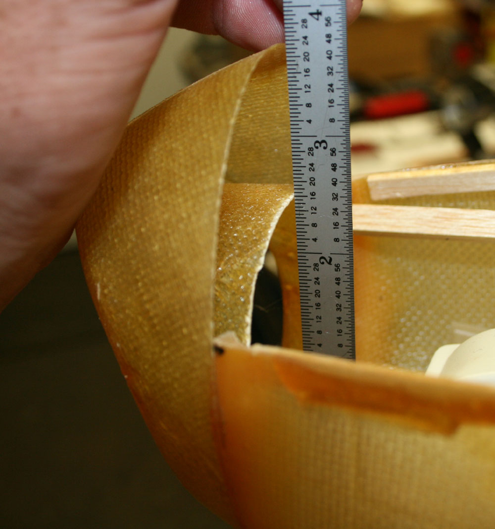

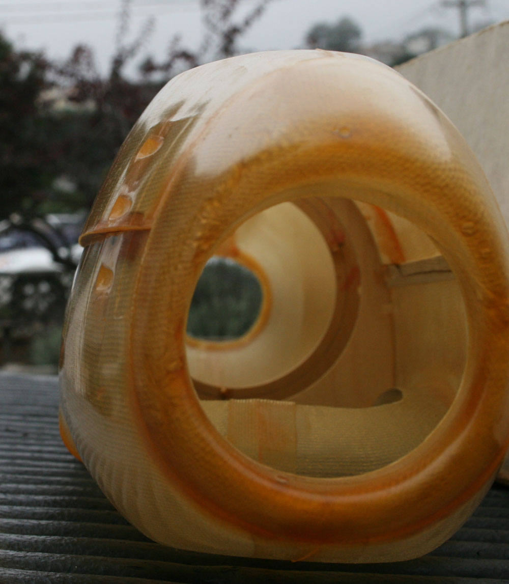

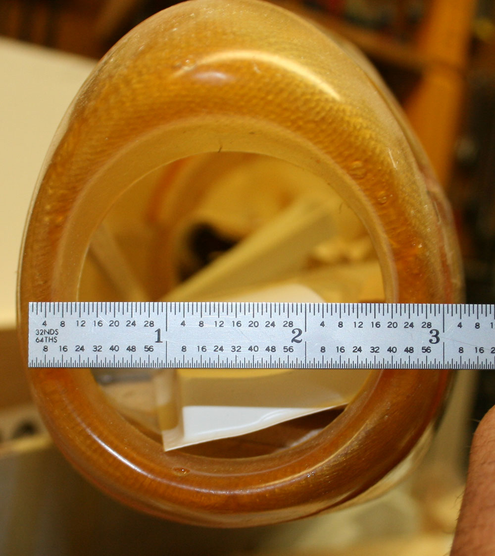

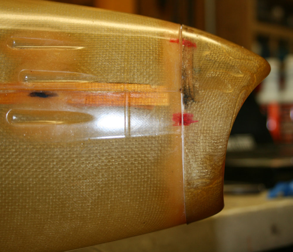

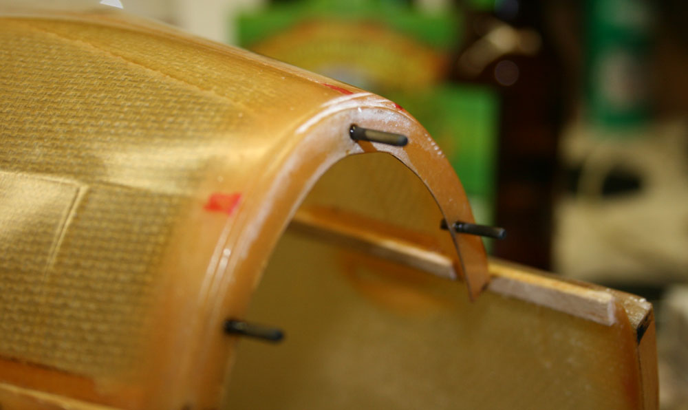

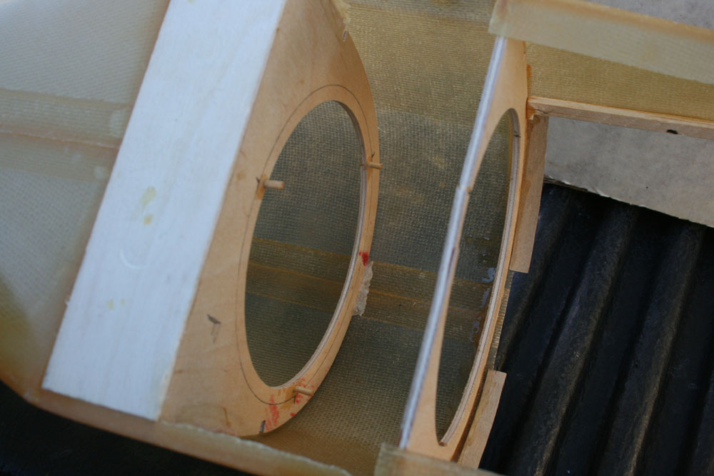

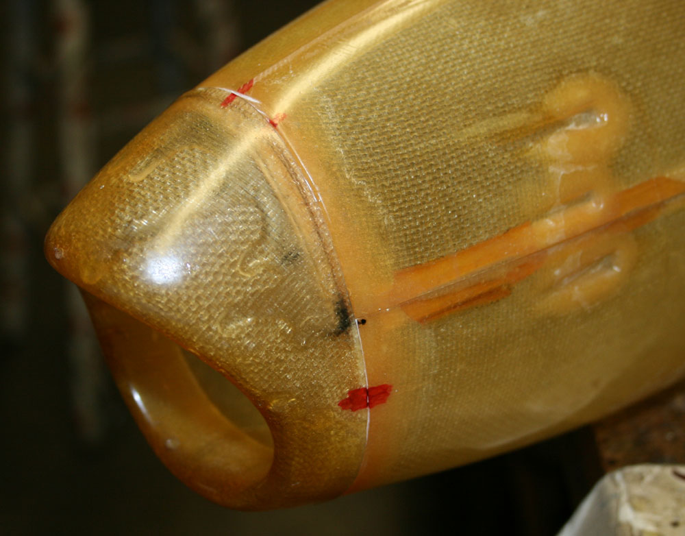

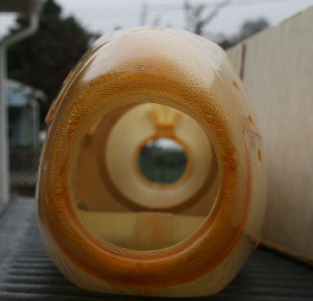

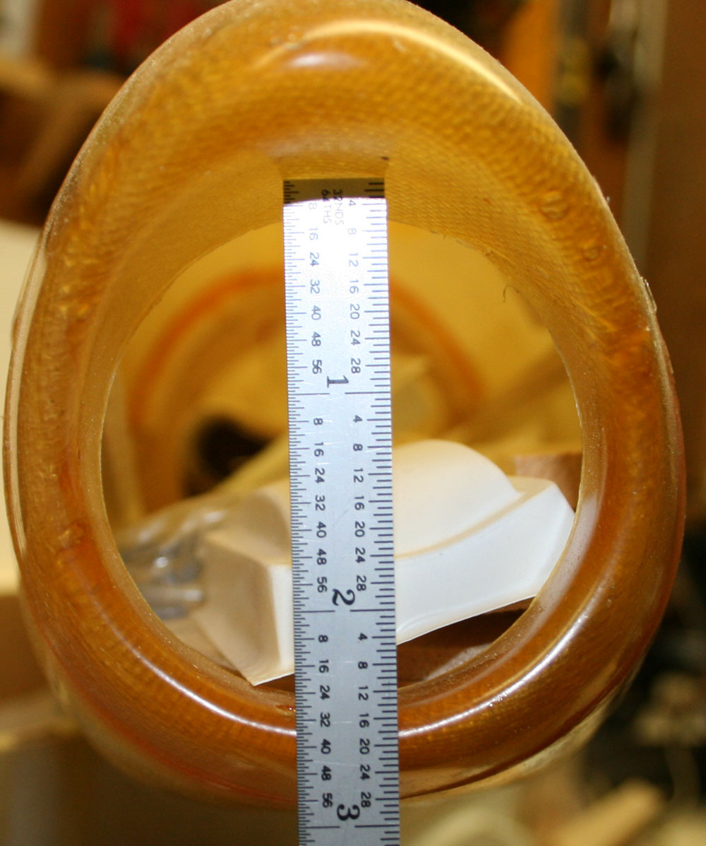

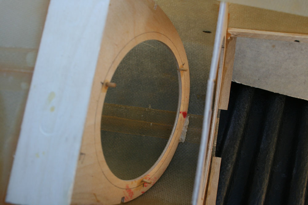

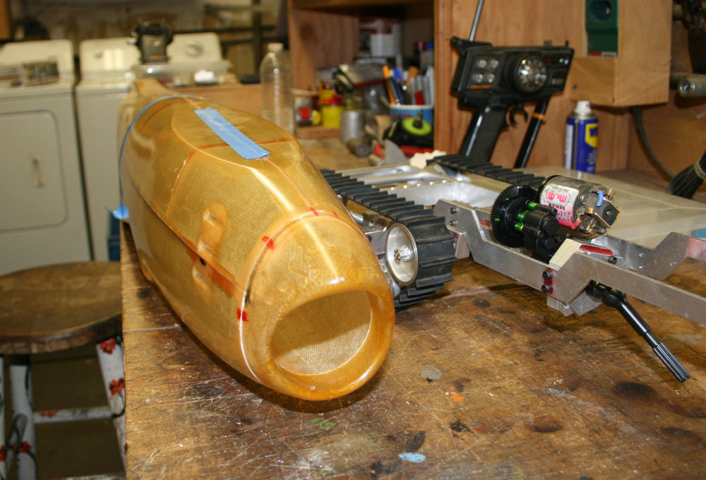

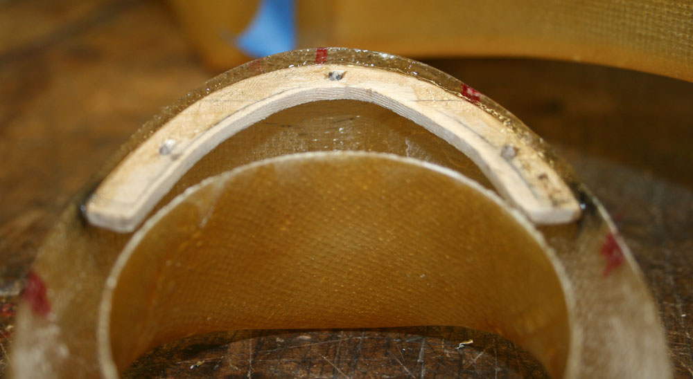

OK, there isnt balsa missing, looks like previous builder had actually started construction. I'm doing some planning here and have looked at the pics you guys posted of where your fans where mounted and trying to determine how and where I will put mine. I've also found some 3" ID carbon fiber tubing I was thinking of using for the ducting. Heres what PO has already done. Note the bulkhead for mounting the old Axiflo fan has come detached. Looks like he barely glued it in and used different glue than other stuff he had done. Also the bulkhead forward of that one is cracked and split on the bottom, so I think I may remake (or perhaps add a layer to) that piece out of some thicker ply and mount my EDF to it. Last two pics, the upper half of fuselage is way wider than lower half (I dont think he followed directions, LOL), so I am presently cutting out the glue bridge between glass and wood bulkheads and gonna attempt to make it match lower half. I might even chop the nose back off and line them all up, its driving me nuts how poorly he started this project and I'm not evn a perfectionist!! Any good glue choices? My motor mount idea sound good? Is there any type of solvent for loosening glue?

Ordered up an RCLander 68mm EDF and mount, waiting to hear back from Scott at Little Screamers. In the meantime, I managed to separate the cowl PO glued on and separate the balsa from the upper fuselage and line everything up right. I didnt like the way the kit instructions have you put three pins in the upper fuselage and just slide it under cowl, so I made a receptacle for the pins and sanded down the cowl on the trailing edge to make it smaller and line up better with fuselage. With any luck, the three pieces will look like one some day!
