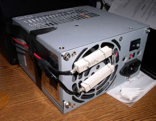

I used two 10W in series. I wired them to the exhaust fan in back.
One black and one reg wire go to the resistors.

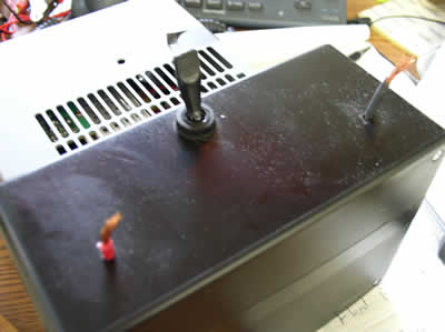

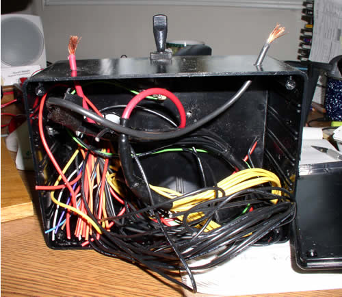

I gathered all my yellow wires (positive) and joined them with a 8 guage wire. I also joined the rest of the black wires together (ground).
I stubbed both 8 guage wires out the top of a project box from Radio Shack. I then connected a switch to the green and one black wire and mounted the switch on top. Preto...all done.
works great with my Triton!

They say 1 ohms. Does that sound right? It has been a while since I bought them.
Since they are rectangular, they strap nicely to the back of the power supply.
