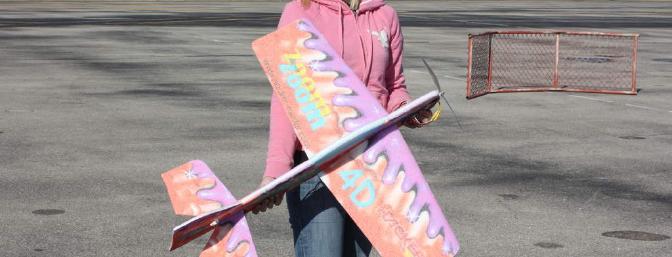

If you are looking for a durable sport or 3D EPP airplane, Hacker Models has you covered. They have several sizes available and all come with pre-painted graphics. Floats are also available, and switching between floats and landing gear takes only a couple of minutes and can be done in the field or at the pond.
The Zoom Zoom 4D is just the right size for easy transport but big enough to handle the wind.
So what's in the box?
Kit includes:
  • Painted EPP foam fuselage and wing
  • EPP wheel pants
  • Hardware (EZ type connectors, pushrods and horns)
  • Prebent landing gear
  • Elevator & Ailerons already hinged
  • Large assembly manual with pictures and text instructions

The Zoom Zoom 4D looks great right out of the box, and the ailerons and elevator don't need to be hinged. You can expect completion in about 4 hours. Also keep in mind that EPP foam does not require the use of foam safe CA.
The builder needs to:
  • Install reinforcement wire for the wing and fuselage
  • Install motor box and the power system
  • Install the rudder
  • Install Aileron, Elevator, and Rudder Horns
  • Install radio system
  • Glue Wing halves and Install wings
  • Install landing gear

The Zoom Zoom 4D comes with foam wheel paints that I opted to leave off as I will be flying off both a paved runway and grass.
I deviated slightly with battery placement and decided to Velcro the battery on the bottom of the fuselage and use a Velcro strap to keep the battery in place. The instructions call for an opening to be cut in the fuselage to accommodate for the batteries. The placement is just behind the landing gear mount, and I was concerned about weakening this area.
The CG was set at 120mm behind the leading edge of the wing per the manual. Throws were as much as I could get with 40% Expo on all controls.
The first flight was behind the house in a grass field. An underhand launch at 3/4 throttle and she took to the air. After some trim adjustments, I began trying some basic aerobatics. The Torque motor had decent vertical performance at 150 watts. Knife edge performance was good and didn't have too much coupling. Hovers were fairly stable but needed a little more elevator throw to lock them in. Rolls are both relatively fast and axial. Snap rolls are also fun but on the second snap roll the rudder locked hard over. Once on the ground, I found the pushrod had come loose in the connector and jammed with full right rudder.
The flight for the video was done on a paved runway in about 15 mph winds. Michael Ramsey was kind enough to fly her so I could take the video. He found the Zoom Zoom 4D to be a delightful flyer even in the wind. He noted on the solid knife edge and inverted performance and enjoyed the harrier landings into the wind.

The Hacker Models Zoom Zoom 4D is as versatile as it is tough. The ability to fly it without landing gear, with landing gear and with floats without tools really makes it fun. The EPP foam construction gives you more confidence in trying maneuvers down on the deck with less fear of going home early for repairs.
Pluses:
  • Versatility
  • Tough EPP Construction
  • Colorful scheme makes for easy orientation
  • Lightweight
Minuses:
  • Included pushrod connectors may come loose if not overly tight
  • Included wheels are too hard (Replaced with foam wheels)
