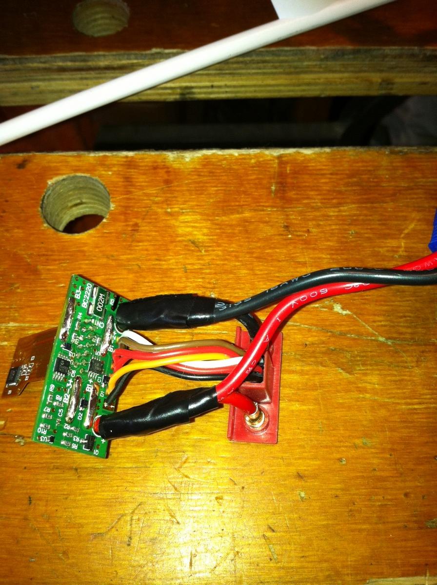

Yes they were brand new and sealed, im only working on one and keeping the other one as a reference, They look like most other helis when naked :-) I am going over them with a fine tooth comb and checking everything thoroughly. It could have been worse it could have come off in full flight !
They say what happens does so for the best, while working on it I have discovered a work around for the problem "run-time error 13" when trying to access the alarm tab.
Power the heli with its battery, then plug the lead into the computer then run the software and bingo you can get to the alarm screen without getting a runtime error.
Happy days

Waking up the thread
BEEN A WHILE SINCE I WROTE but had to solve many problems , spent a month in the middle of Brazil visiting my Mother, got a Power Chair and a ramp for the car since my "mobility" is going down the drain, so just NOW tried ONE MORE TIME to make my second MD530 fly.
ALAS....! to no avail !!!
This heli was purchased from our friend SIMAGES about 12 or 13 months ago, and the defect has been ongoing since then.
It seems that EVERYTHING is right on, the battery is charged, the start up cycle goes through normally, the motor reacts OK to the lifting of the trim button, the switch on the top right side is put FWD and BCKWD but even as the blades are turning at the usual speed : THE HELI DOES NOT LIFT OFF THE GROUND,,,,,,,everthing else is responding correctly, blade plate is seen to tilt with AIL and ELE inputs, RPM sound as they always do in flight ..... ???????
Our friend FABIO had promised way back some help by using SKYPE and reversing the screens so he can plan the necessary inputs in the software, but he is so busy that the help hasn't arrived at all .
IS THERE ANYBODY OUT THERE ( XRAYTED ???? where are you ???) that knows what to do ?
This HELI is the one that I purchased from one of our old time users who gave up the sport, .....and the heli has NOT flown since it was received....... My original MD530 is a sweetheart of a toy and it gets flown all the time.
RICK HELP ME !!!!
I tend to believe that the ANSWER to this puzzle will be in : HOW IS THE PITCH OF THE BLADES CONTROLLED OR MODIFIED, USING THE SOFTWARE ......
am I right ?
BARRRICK is offline Find More Posts by BARRRICK

Hi Barrick. Assuming you have the required RPM, the only other factor to get it in the air is your pitch curve.
You are going to need to verify what pitch you have at your various stick positions and yes, there is a standard 5 point pitch curve setup within the PC software that works just like setting up a pitch curve in any traditional computer TX. I know you have many helis and assume you also have TXs with them and have programmed pitch curves on them. It's just as simple within the PC software and if I remember correctly you will find the pitch curve tab, called CP curve under the Control tab within the software. Post # 97 of this thread has some of my old screen captures from the software to show you where the primary functions, pitch curves, expo, dual rates, etc are and what they look like within the software.
