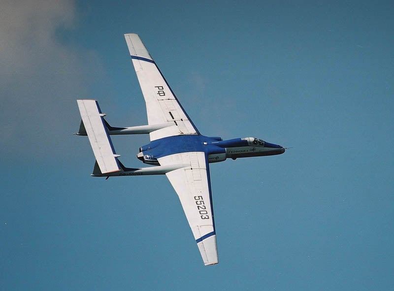

A bit off topic, but the picture you posted in the first post reminded me of a failure of those types of pictures when trying to convert an actual airplane/glider to a scale model.
When looking at the head on view the wing appears to have andihedral. What is not being accurately represented is the wing flex that will occur on the real airplane while in flight and which will effectively give it dihedral or more accurately a curved upward wing like a hobie hawk but less dramatic.
Why this post jogged my memory was because a long long time ago my dad and I (well, mostly my dad unless constant watching and moral support is the same has helping) scratch built the Russian version of the U2 the Mystic.
The Mystic
When trying to determine the wing plan form I remember we had a debate on whether to give it anhedral to "keep it scale" or to go with a dihedral or polyhedral wing.
Anyways, enough digressing and nostalgia.
Post up some pics of your progress and work even if it's just a foamie.
-Jonathan
EDIT: Oh fun! Was actually able to find some old pics of the model. My dad and I are the only white guys This was taken on top of Oishi Kogen (big rock plateau) in Japan. Note the final design was flat bottom surface of the two inner panels (technically anhedral on the top) with polyhedral tips.
