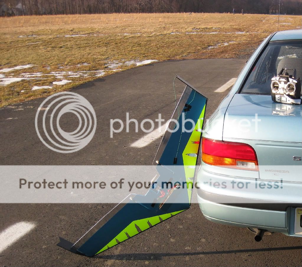

Been getting complaints every time i fly my wings so i started looking for a quieter setup the was still efficient. I realized i had a striker motor laying around and wondered what i could do to increase power handling.
I used this stryker 1880 motor and achieved 90 mph flat and level in the 50.
I am tempted to fly it again using a 6 x 4.5 gas prop to see if i can get 100 even.
Proof video:
Proof photos:
[img]
Plane weight :40 oz 1.2" thick at root 1/2" at tip. 4350 4s lipos.
I removed the endbells and went to town with my dremel. The setup is 4s 4350 30c and 6x4 windsor on a 40 amp Turnegy/ switching bec.
