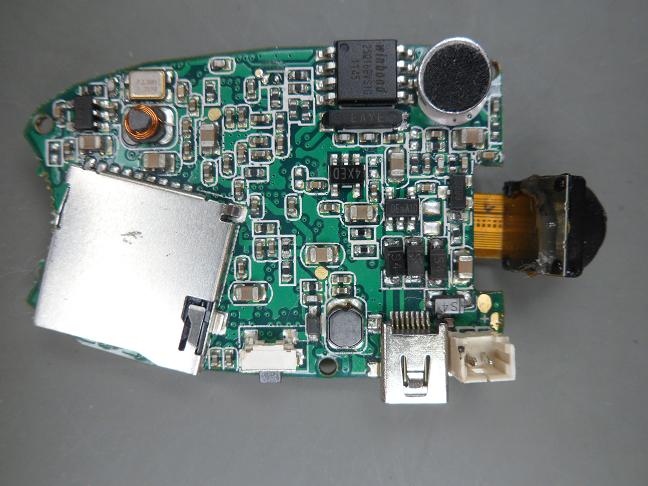

Originally Posted by rc9 View Post
. The picture above is from a V2 #11 with the 2 LEDs situated below the lens cut-out.
I´ve been asking for advice on the #18 tread but now when I came across this
pic........ maybye.... Isoprop you don´t happen to have a pic of the flipp side?
Does the #11 cam also have 2 led´s (red charg/yellow on)?
My Problem will remain seens I can´t load any firmware anyhowe, but at least I´ll know why if I can confirm it´s not #18 but an #11 v2 cam I´ve got
The coil at the top left was broken by the previous owner but should look like the one next to the USB socket at the bottom right. This is how the board looked before I started stripping it....

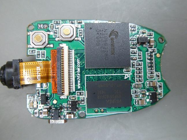

It was originally sold as a #11, but I believe is identical to the #18. When (if) I manage to repair it, I'll know for sure. Among other things, the DRAM Hynix chip on the first picture is shorted. Since they are identical, both boards have 2 LEDs.
I believe the only difference between the #11 and #18 is in the bootloader, resp. the firmware.
Here's the reverse side.
