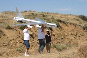

Hope to see that at the fest Bill. Here's a couple of pics for inspiration.
  • Name: IMG_1844b.jpg
Description: 33 pounds of German warfare. 33 pounds of German warfare. 48.9 KB · Views: 236
  • Name: IMG_1357.jpg
Description: I think Joe said the P51 will weigh in around the 50,lb range so go Big. I think Joe said the P51 will weigh in around the 50,lb range so go Big. 83.4 KB · Views: 241
