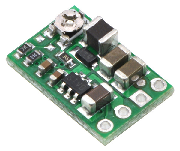

You're right, it is out of stock. I looked around and found a few more, like this one:
It can handle (survive) up to 42v in and has adjustable V-OUT. In order to control the ripple, which I assume is the same as the initial voltage spike that the regulator may experience when first plugged in, I think that I could prevent it with a capacitor (I'm not an expert, so I hope someone will correct me if I'm wrong about this).

For your application with 6S a step down converter is surely sufficient. Make sure though that it can handle the current of all components you add to it on it's output.
Getting rid of the ripple can be difficult. A capacitor alone is most likely not sufficient. You would need at least an LC filter (a coil and capacitor) but even then it's not always that easy. If you search this forum you will find sufficient information on filters though.
How bad the ripple is depens on the regulator and also of course of what you connect to the output meaning that some devices (cameras, video tx and so on) filter good enough for their own needs. So you could try and add a filter as you go.

Ok guys, here's what I'm thinking:
6s battery - Polou 12V step down regulator - LC filter (already have the one from dpcav) - camer/tx/etc
Anyone foresee any issues with that setup?
