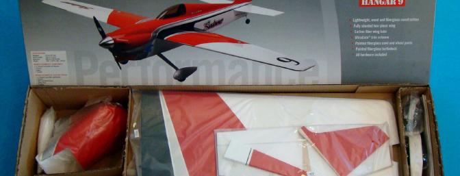

The Sundowner 36 is Hangar 9's latest addition to their very successful Sundowner Pylon Racing series. The 36 is the smallest in the series so far and has recently been certified by the National Miniature Pylon Racing Association for the new Electric Formula 1 Pylon Racing Class of competition. The Sundowner 36 features a fully sheeted built-up two-piece wing and the excellent parts fit and finish we have come to expect from Hangar 9. While it is slightly larger than its stable mate, the E-flite Pogo LR-1A, the Sundowner is more streamlined, and the higher aspect ratio wing makes it smoother around the pylons.
If you are wondering what all the hype is about with this EF-1 racing thing, then you should probably check out the RCGroups Thread on EF-1 Racing.
If you're feeling the "Need for Speed" or if you think you might want to try this new EF-1 class of racing, then the new Sundowner 36 is the perfect place to start. Let's put one together and see how she stacks up against the competition.
If you're not too sure about this racing thing, but you want to have the wildest sport/aerobatic plane at your club field, the Sundowner 36 may have some hidden surprises in store for you. Stick with me to the end of the review, and I'll show you how to turn this fire-breathing Reno-racing dragon into a pussycat.

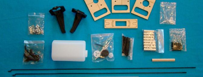

Kit Includes:
  • All Parts pre-covered in an attractive UltraCote color scheme
  • Hinge Slots precut and CA Hinges in place
  • Fully Sheeted Fuselage
  • 2-Piece Sheeted Wing with Carbon Spar and mounting tabs
  • Horizontal Stabilizer & Elevator
  • Vertical Stabilizer & Rudder
  • Fiberglass Motor Cowl & Wheel Pants
  • Streamline Canopy and Large Front Hatch
  • 2-piece engine mount, fuel tank, and generous hardware package
  • 48-page photo-illustrated assembly manual

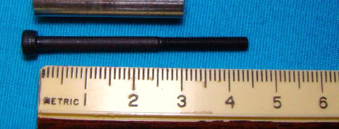

Motor Installation
The E-flite Power 25 1250kV motor has been officially approved by NMPRA for the EF-1 event and has become the motor of choice for this event. Since E-flite made two versions of the Power 25 motor, I made sure I had the 1250kV NMPRA version for this Sundowner review. When I tried to mount the motor, I found that Hangar 9 had updated the spacer and bolt lengths for the Power 25 and that the manual still referred to the original shorter dimensions. The Power 25 motor used 30 mm (1-3/16") spacers and 45 mm (1-3/4") bolts to mount the motor to the firewall. Future versions of the Sundowner manual will reference these longer dimensions.
Before I mounted the motor, I solved the mystery of the undocumented triangle stock. I found a piece of triangle stock among the hardware packs, but I couldn't find where it belonged. If found that the left side of the rear of the firewall was missing its reinforcing triangle stock because some of the larger combinations of motor/engine mounting bolts would interfere with the stock if it were installed. Since the Power 25 mounting bolts did not interfere, I epoxied the stock in place.

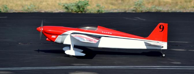

The completed Sundowner weighed only 3 pounds and 9 ounces ready to race! I was very surprised. The finished Sundowner weighed almost 1/2# less than the lightest advertized kit weight and only 3 oz. more than my Pogo. The Sundowner was only 6 oz. over the minimum weight allowed for the EF-1 class of racers!
To achieve the proper CG, I mounted the 4-cell E-flite battery all the way forward against the back of the firewall.
I set all the surface throws at the recommended amounts and, since I prefer to fly with exponential, I added 25% exponential to the low rates and 35% exponential to the high rates.

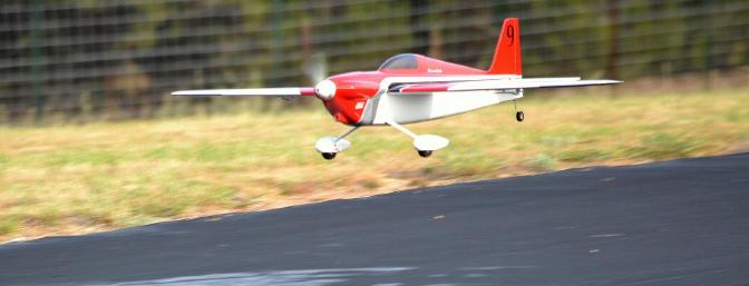

The bane of pylon racing is the takeoff. High-powered motors and full RPM takeoffs can produce some nasty torque effects. Luckily the Sundowner doesn't exhibit near as much takeoff torque effect as its sibling the Pogo. I found that I only needed a touch of right rudder on most of my takeoffs.
Landings took a little practice. The Sundowner 36 is a slick airframe and with the 8x8E prop it doesn't slow down very easily so I had to cut power on the downwind leg and go out further than with my sport planes before I turned on final. The Sundowner can be slowed down a little with the elevator for a 3-point landing, or wheel landed and allowed to coast to a stop if your runway is long enough.
In sport plane configuration with the 10x7E prop, the Sundowner 36 slowed down much quicker and settled easily into a nice steady 3-point landing stance. It still took a longer landing approach than a Pulse 40, but it was very manageable.

  • Motor Spacer/Bolt Dimension Error
